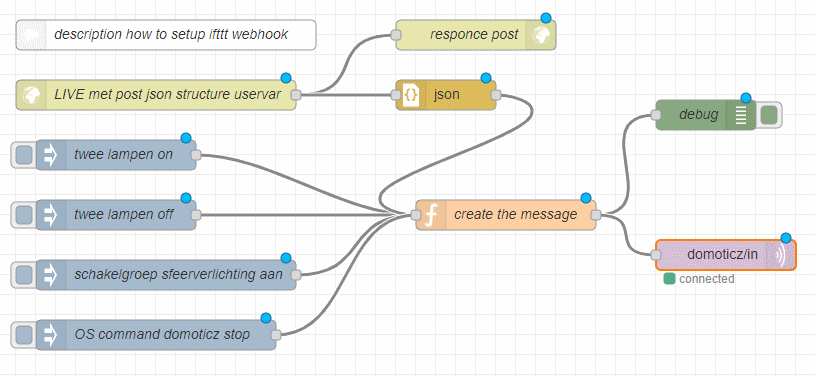

pvklink
Posts: 822
Joined: Wednesday 12 November 2014 15:01
Domoticz version: latest b
Re: IFTTT api
Post by pvklink »
@waaren, thanks for the wunderful script you made for me!
I use this script myself as a sort off "API" between domoticz and MQTTT.
My usage/Procedure:
1. i give a Google Assistant command
2. IFTTT/webhooks pics it up and send a json message via IFTTT to my NODE-RED broker
3. NODE-RED makes this message suitable for MQTTT
4. MQTTT send this message to domoticz via the MQTTT-domoticz hardware plugin.
Result is that a uservar(IFTTTvar) in domoticz is filled with a json message (the content off the IFTTT webhook)
5. when the uservar is changed, the script automatically fires and executes functions like:
an OS command
a switch command
a switch selector command
fills a uservar
sends a message
executes a group or scene
AND yes! This can be executed much easier by:
1. call a domoticz API/JSON URL's for a spectific device and dont use this script at all!
2. call a domoticz API/JSON URL's for an update of the mentioned uservar(IFTTTvar) so that the script is executed directly. You dont need NODERED en MQTTT for that.
Why creating an extra script?
- Advantage of this way of executing is that you can add extra options yourself (or in my way @waaren did that for me) that default domoticz/json dont offer....
Why using IFTTT and webhooks?,
- because Google needs help with sending json url's and send it to domoticz.
Why using NODEred and MQTTT.
- You dont need this, i like doing it the hard way and mess with new technology...
Finnaly
Fo those who also wants to play with nodered and mqttt. I used the default install doc's from the internet and use them on the same device as domoticz, a rpi 3b.
Below you can find my NODE-RED flow configuration. In this configuration i also described how to config your IFTTT/webhook applet/service and i even have some examples that you have to adjust and after that you can test nodered/mqttt/domoticz-script manually without Google assistant/ifttt.
NODERED / IFTTT
[{"id":"4b581568.d34f6c","type":"comment","z":"612f3ecd.84333","name":"description how to setup ifttt webhook","info":"in ifttt webhook use:\nurl = https://<user>:<pwd>@<webadres>:1880/pvkvar2\nmethod = post\ncontenttype = application/json\nbody= [{\"obj\":\"lantaarn\",\"act\":\"On\"},{\"obj\":\"Lamp tv links\",\"act\":\"On\"}]","x":230,"y":80,"wires":[]}]
