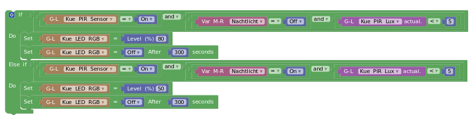

How different is dzVents from blockly where the script waits until an action becomes true. Here not a single flicker for the light can be seen, it stays off.
Can you please show your Blockly and also to what hardware type the Kue LED RGB is connected ?

Okay the device is a FIBARO System FGRGBWM441 RGBW Controller
My blockly use also a night dimming function, here the timeout works pretty well.

Solderbro wrote: Saturday 17 August 2019 22:02 My blockly use also a night dimming function, here the timeout works pretty well.
Thx! the delayed Off command in this Blockly should send the same commands to domoticz as the dzVents script. If it does send other commands I am clueless to what and why.
If you are interested you could check both with a virtual RGBW device and see if you get the same (unexpected) results. I did test both with a virtual device and do see the expected behavior.
