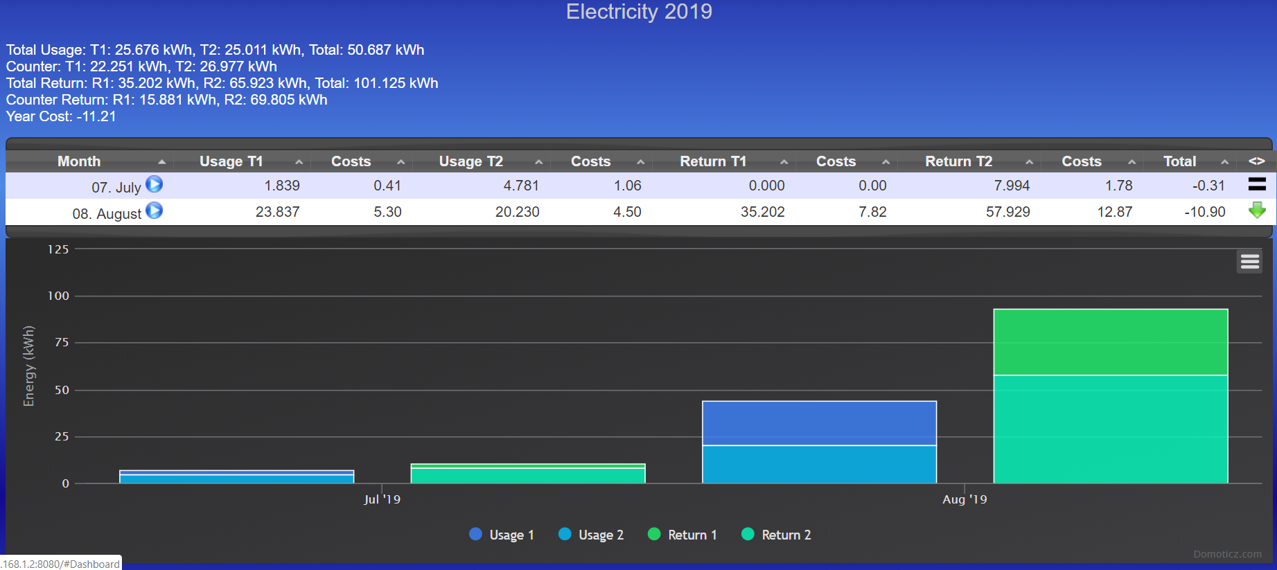

On the electricity report page I see the following:
What is the difference between "Total usage" and "Counter" and what is the difference between "Total return" and "Counter return"?
I recognize the values 26977 (T2) and 69805 (R2) from the device page, but the readings 26137 (T1) 37445 (R1) from the device page I don't find here.
Is this an error in Domoticz or do I overlook someting?

Hi Jan,
Your P1 smart meter cuts the values on its display obviously. There fore you see:
jvdk wrote: Sunday 11 August 2019 18:30 T1 26, T2 26, R1 37, R2 69 (at the moment the T1 and T2 readings are the same :D )
So you have the value in kWh. In the device listing you have the first four values in Wh.
Your P1 smart meter is installed in July 2019 or you have start monitoring it with Domoticz since July.
The "Total Usage T1" has been 1.839 (July) + 23.837 (August) = 25.676 kWh.
For "Total Usage T2" this has been 4781 + 20.230 = 25.011 kWh
The "Total" gives then: 25.676 + 25.011 = 50.687 kWh
The same calculation can be done for the "Total Return"
The calculations above are done by Domoticz and comprises the whole year. If December has ended the value should be equal to your yearly bill.
The "Counter" comes, as you have already seen in your Device list, as far as I know, from your smart meter protocol and so should be equal to what you read on the smart meter itself. I believe that these are updated in the log not so frequently as in the device list.
I guess that your screenshot is made on a Saturday or Sunday, because the normal cost T2 is up to date, while the low cost T1 is somewhat behind.
I hope this gives you some info, but I do not believe that there is bug in Domoticz.

I think you are right; the differences are probably caused by another update rate. Now, Monday at 21:30 h, non of the values in de device list are the same as found in the report overview.
