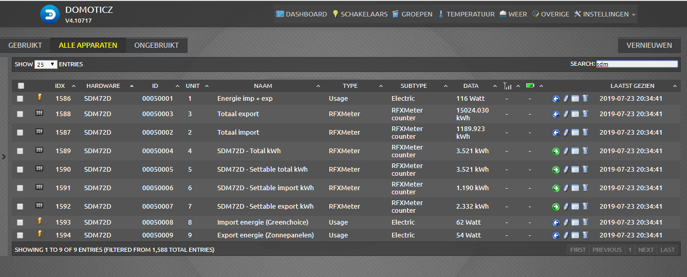

MFxMF made a python plugin for the Eastron SDM630 Smart meter. I modified his original code to make it suitable for the SDM72D-M smart meter.
The meter is connected via modbus and an RS485 USB adapter (very cheap on ebay!) No further coding needed!
