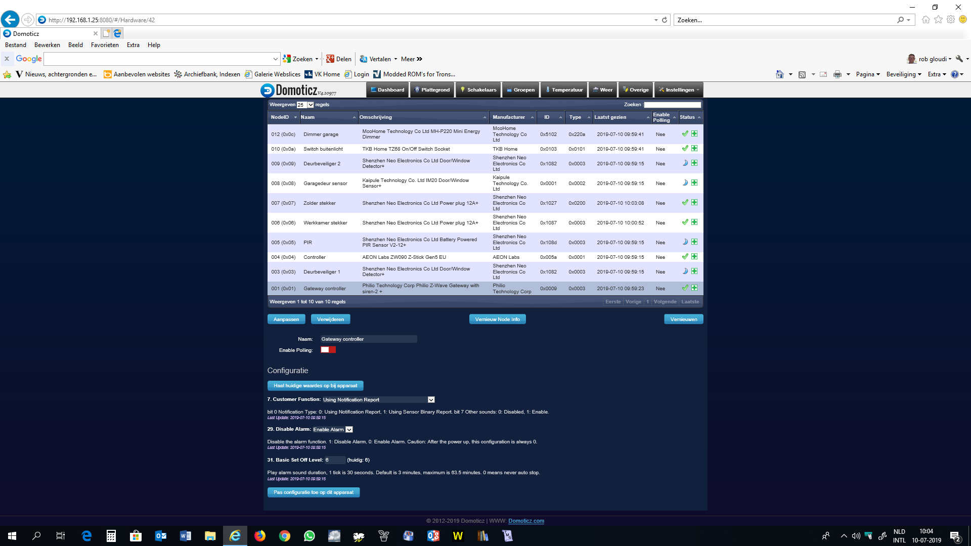

To have a broad mesh network I have two controllers in my z-wave network. An Aeotec gen5 and a Philio PSC03-A1 Gateway with siren ( same as Air Live SG-101 ). I managed to set it up. Domoticz openzwave 1.6 picks up great. Unfortunately there is no config xml ozw for the philio gateway. And philio Taiwan states that they do not use ozw. Domoticz is not aware of the siren included in the gateway. Faking ozw with the XML for the philio siren pse02 does not help, cannot change parameters, no siren device shows up in Domoticz. Somebody has bright ideas for my problem. Sending RAW data to the gateway with lua or some other method? Please gurus out there can you help?
Philio Gateway Connections.jpeg (47.79 KiB) Viewed 339 times
