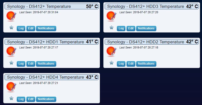

This plugin monitors the following services on Synology via SNMP service:
You can find the plugin on: https://github.com/febalci/DomoticzSynology
NAS Status
HDD Empty Space %
NAS Temperature
HDD Temperature up to 4 disks
NAS CPU
NAS Memory
UPS Status
UPS Charge %
UPS Battery Time Left
