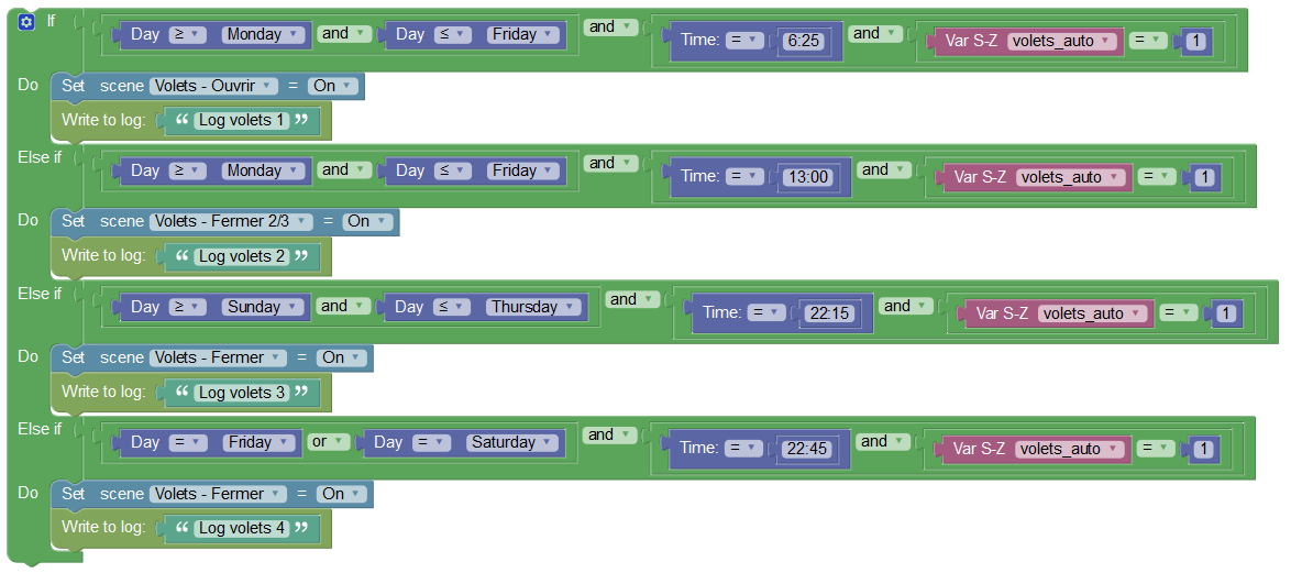

I have a problem with a blockly script. I send an order to open or close shutters at certain times. In my script, the opening is scheduled at 6:25 though the shutters are operated at 6:05!
For other movement commands, that's fine. I do not understand where the problem comes from. Can you help me ?

Did you check if no other timers / scripts could interfere with this ?dflandre wrote: Monday 24 June 2019 10:47 I have a problem with a blockly script. I send an order to open or close shutters at certain times. In my script, the opening is scheduled at 6:25 though the shutters are operated at 6:05!

I cannot reproduce this on my test system. Could you add some log statements in the action areas so you will clearly see which of the if conditions triggered the action ?

Re: Event on wrong time
I done it this way.
I'm waiting for the result.

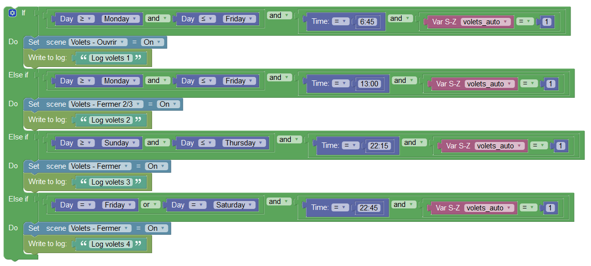

Here is the continuation :
I changed the trigger time of the command in the script (6:25 -> 6:45).
The command is always activated at 6:05. In the log, we see that it comes from this script. The trace "Log volets 1" is found at 6:05.

Thx. I am going to set up some tests to analyze further. Can you please copy the exported Blockly and paste it here ? That will make it easier to simulate your setup.

Found what is causing this !dflandre wrote: Monday 24 June 2019 10:47 I have a problem with a blockly script. I send an order to open or close shutters at certain times. In my script, the opening is scheduled at 6:25 though the shutters are operated at 6:05!
The time condition in Blockly expects a time in the format of hh:mm and it turns out that Blockly is rather strict on this. So if you enter the times as 0:25 and 6:25 and the likes, the condition is evaluating to true at 0:05 and 6:05. If you enter the times with the leading zero, the if parts are evaluating to true at the expected times.

2019-06-26 06:05:00.555 Status: Log volets 2.1 6:25

Solved in V4.11060 by @gizmocuz by patching www/app/events/blockly_xml_parser.jswaaren wrote: Wednesday 26 June 2019 8:22The time condition in Blockly expects a time in the format of hh:mm and it turns out that Blockly is rather strict on this. So if you enter the times as 0:25 and 6:25 and the likes, the condition is evaluating to true at 0:05 and 6:05. If you enter the times with the leading zero, the if parts are evaluating to true at the expected times.dflandre wrote: Monday 24 June 2019 10:47 I have a problem with a Blockly script. I send an order to open or close shutters at certain times. In my script, the opening is scheduled at 6:25 though the shutters are operated at 6:05!
