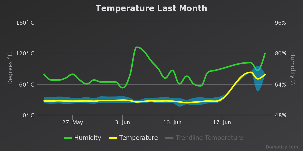

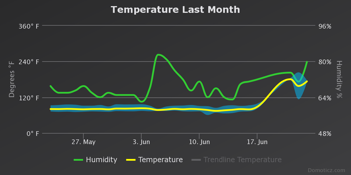

1. My trusty RPi which was running Domoticz died. So I compiled/installed Dometicz in my server (version V4.10925). I figured one computer less is good and server has plenty of resources. I took the database from dead Pi and copied it over, then started Domoticz. Took the same USB Zwave controller dongle and plugged it into server of course. Bingo, everything was in place. My hardware (switches, sensors, everything) was all there, scenarios, whatnot. I had temperatures in Celsius in RPi.
2. I did not do anything with cache.
3. Temperature setting was C in RPi, now when I set it to C I get temperatures in F. When I set it to F then I get close to 200 degrees.
See attachments, my RPi died on June 16th, these are from my outdoor temperature sensor.
Me scratching head.
Me scratching head.
- temperature-last-month_C.png (95.53 KiB) Viewed 4461 times
- temperature-last-month.png (93.5 KiB) Viewed 4461 times

So the domoticz executable is locally compiled and domoticz database is copied. How did you update the other domoticz subdirectories like Config, dzVents, scripts, plugins, www ?Segfault wrote: Sunday 23 June 2019 13:30 1. My trusty RPi which was running Domoticz died. So I compiled/installed Dometicz in my server (version V4.10925). I figured one computer less is good and server has plenty of resources. I took the database from dead Pi and copied it over, then started Domoticz.
They should all be aligned with your domoticz version
