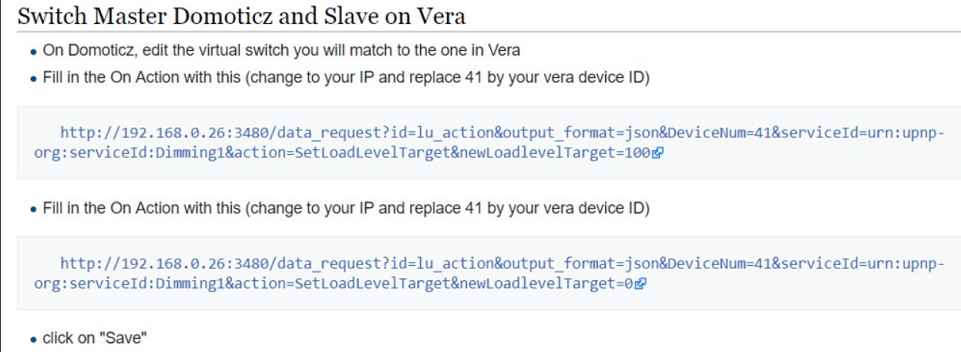

I have been a user of the Vera controller for quite some time, though I am still very much a novice in this area. I wish to use the Domoticz controller in conjunction with my Vera controller. At present I plan to use Vera to do most of the work, initially only using Domoticz to add devices which Vera can't handle, so I need the two controllers to play nice with each other.
The Domoticz controller is running on my Windows machine. I have checked out the wiki on how to use both systems here : https://www.domoticz.com/wiki/VERA but I have a question....
Above is my issue... Why is it talking about Virtual Switch on Domoticz when it is the actual device on Domoticz that I want to replicate in Vera? Do I need to create a Virtual Switch on Domoticz that copies the real switch on Domoticz?
