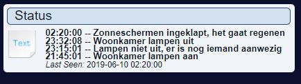

this is what the output looks like when written to a text device
the 2:20 should have been 16:10

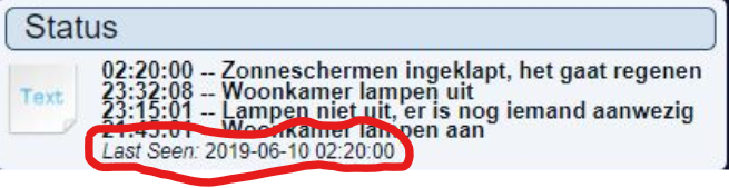

Sorry to be such a pain. (I am just trying to help). I don't see the calling script starting in the log. Do you still have the log of 02:20 ?
Reason I am asking is that the last update time of the text device is also 02:20 leading to my assumption that the system- and domoticz time was 02:20 the moment the text device was last seen
Dzvents has no access to that attribute so either the system time was wrong or the text device was actually updated at 02:20.

oh man, how dumb can i be.
here is the log of that moment
the script skips double messages
at the time i was watching the screen(16:10) i noticed that the sunscreens went to the OFF position. checked the textdevice and thought the time was wrong.
it never occured to me that the first time it triggered was at 2:20 and that the second time at 16:10 (which is skipped)
well thanks for the help.
