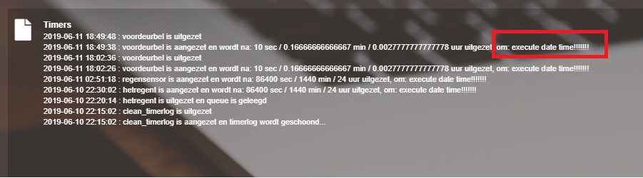

I try to store the timers manually in a text field so i have my own timer log in dashticz..
Next script seems to work ok when i add 1 thing i dont now how to do...:
a) log execute date/time, see !!!! execute date time in the script for the exact place (this date/time = dz.time.rawTime + Durtimer

In the meantime a made a second logging for some triggers like: for xx minutes or after xx time. I write them in a switch as text and publish them on dashticz so i can check if they fire!
Only thing i cant get to work is to make a global service thats calculates the daytime from now + seconds...
For example now+ 86.400 is tomorrow 12-6-2019 20:27. I need this function in more scripts.
If i have this i can easily check when a event has to start and if it has started....
i need this info in the below script (that does work) on place "execute date time!!!!
it has to calulate something like: tonumber(dz.time.rawTime) + tonumber(Durtimer)

pvklink wrote: Tuesday 11 June 2019 20:29 For example now+ 86.400 is tomorrow 12-6-2019 20:27. I need this function in more scripts.
The Lua date / time handling is indeed not the easiest part to understand ( even with the simplified API that dzVents brings to the (time) table )
If you implement the script below and look at the produced log it might help you to understand how Lua deals with displaying dates / times (now, past and future)

@waaren Perfect! with the given examples it was a piece of cake!
Looks great now!
