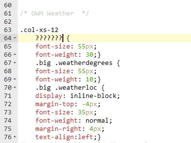

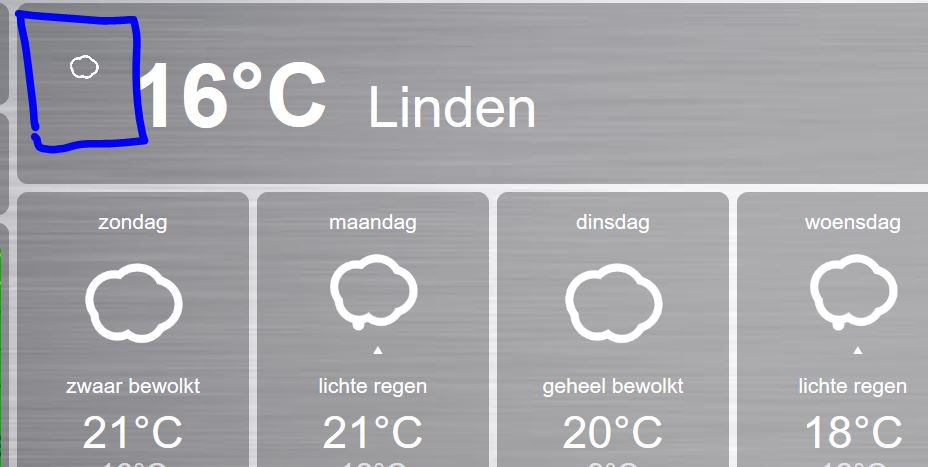

I'm struggeling with my custom.css to make the icon in the OWM weather section bigger. From a distance I couldn't read the degrees so I made them bigger but I can't find the correct reference to the Icon in order to make it bigger as well.
Does anyone know how to do this? I see often dashboards where this icon is really small. So I suppose some more people would benefit from it.
The section in my dashboard:
OWM Weather big.JPG (50.87 KiB) Viewed 2460 times
The section in my Custom.css:
.col-xs-12
font-size: 55px;
font-weight: 30;}
.big .weatherdegrees {
font-size: 55px;
font-weight: 10;}
.big .weatherloc {
display: inline-block;
margin-top: -4px;
font-size: 35px;
font-weight: normal;
margin-right: 4px;
text-align:left;}

Lokonli wrote: Tuesday 22 December 2020 21:50 Please add a screen shot, and indicate what you would like to have changed.
Hi Lokonli thank you for looking into this small issue.
As you can see in the screenshot below, the cloud-icon is not inline with the text showing the temperature and city.
in my custom.css I got these parts of weather related css:
[data-id="currentweather_big"].big .weatherloc,
[data-id="currentweather_big"].big .weatherdegrees {
  font-size: 15px;  /*default font you see is 24px, decrease that number at will if you want a smaller font or increase otherwise*/
  icon-size: 20px !important
.block_currentweather_big_owm {
  height: 80px !important;
 .block_currentweather_big_owm .skycon {
  max-width: 85px;
  width: 85px;
  text-align: left;
 .block_currentweather_big_owm .title {
  font-size: 70pt;
  margin-left: 50px;
 .block_currentweather_big_owm .weatherloc {
  font-size: 150pt;
Domoticz beta | Dashticz beta | Synology DS415+ | Wall tablet Teclast 11.6inch (Android) | TADO v3 controlled heating

One other thing I'm also struggeling with regarding the weather icons.
On my standby-screen I want the days of the week with a bigger font, and also when possible the weather icons itself a little bigger (or bold)
Also the space between the weather forcast and the clock I cannot determine why that's so large.
my standby screen config:
