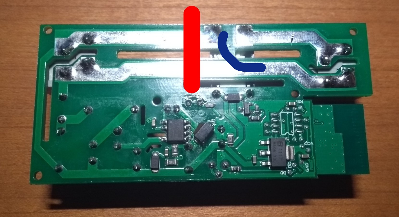

Else I have an unused KSentry powered zigbee on/off relay switch that I can modify (remove the 220V from the output). I have to saw in the circuit board to do so, so I feel happier to use an off the shelve solution...

For your information, these are the modifications I plan to do:
Cut the board on the red drawn line to break the 220V lines.
Solder a connection (blue line drawn) from the loose relay pin to the output line.

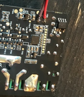

Hi I'm New here but saw the Potential free problem I too was having and have found a solution that works for me.
I use some Aqara LLKZMK11LM modules and those are NOT potential free without the Red Wire unfortunatelly.
As my intention was to use it to open my Frontdoor StrikeLock running on 12Vac the 230Vac on the relais could pose a slight smoke problem.
Due to the fact I have already 12Vac my thoughs where isn't it possible to power the LLMZMK11LM with this as well.
Sort Answer no not directly.
But!! after some messuring it does run on 5Vdc.
So a ac-dc stepdown converter to get the voltage from 12Vac to 5Vdc solved it.
Attached some pictures of the location to where to solder the wires to power the module.
After this mod the pins in the relay are without power and it can now switch low voltage without issue :)
I have placed some tape on the first 3 connectors so using them is not possible anymore.
Hope this helps some of you
Thijs
View recent photos.jpg (42.67 KiB) Viewed 6134 times

So you can power on the device with 5/12V ? Realy Usefull ^^
But it still complicated to use it as free potential contact, even now the tension is 5/12 V ?
tcarnal
Posts: 6
Joined: Saturday 28 March 2020 12:47
Re: Potential free zigbee switch?
Post by tcarnal »
The 5V isn't measured on the Relay pins (L1 and L2 Contact) anymore as it was with the 230v
It's most properly because the 230v part of the module is skipped.
So yeah it switches low voltage perfectly :) no extra voltage shown on my MultiMeter.
Measured the 5v Part of the print when attaching a load to the IN Contact (14vac) and the voltage didn't whent up.
Also the Relay when powerd L2 and L2 only showed the 14vac attached to the IN Contact
When nothing is attached the 5v isn't meassured on the L1 and L2 contacts
Only Downsite you can't use the L and N to power it anymore but in my case this is perfect as the Location where it's places only has 12vac and 12vdc :)
hope this answers your question
