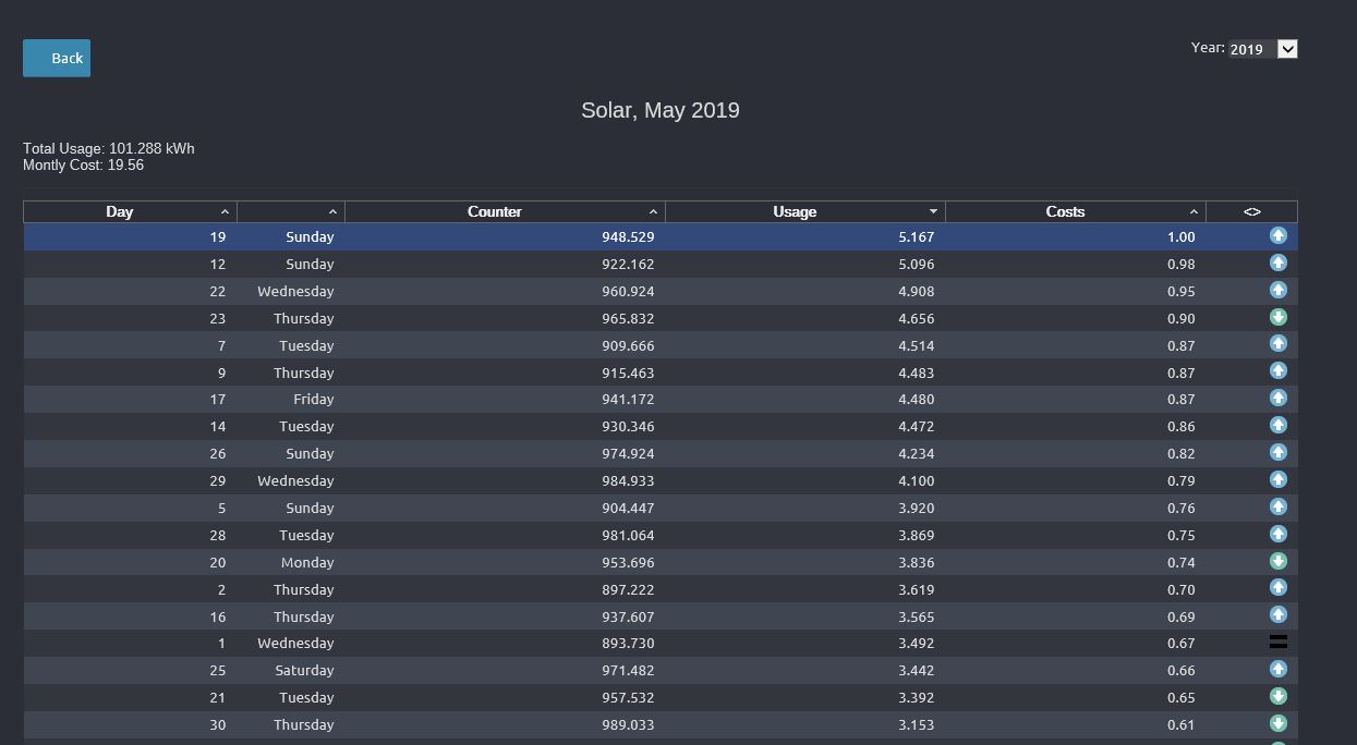

You can see it by going to the report page of the solar energy sensor, but still you have to go month by month and sort by "usage" and it will show the day with biggest "usage".
- Capture.JPG (76.08 KiB) Viewed 604 times

Yes, thank you for your thoughts, but that's is manually. I think about storing the highest in a user variable and check every hour if there is a higher value then the stored version.
Then store the new highest value in the variable and send message to the user and display in the dummy switch.
