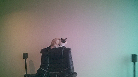

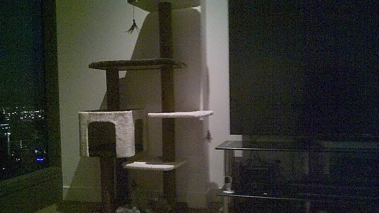

A couple of still images taken with the camera (resized for the Domoticz forum):
1) Good lighting at night (The camera image shows a lot of grain)
2) Taken during the day with a combination of LED and natural sunlight. A small amount of grain is visible in the image but the picture of easily clear enough for object recognition purposes.

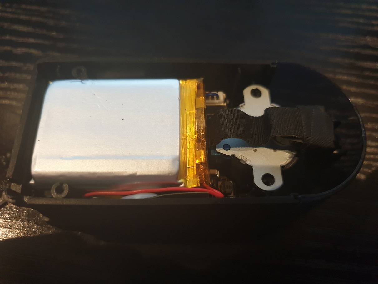

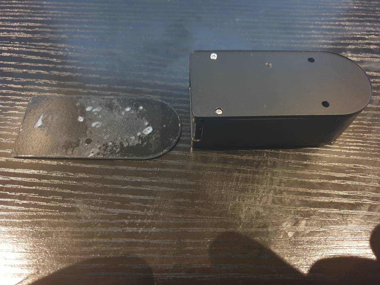

Ended up doing a few hardware mods to this cameras as well:
1) Removed the lithium ion battery (camera still works fine via USB without it).
2) Removed both the blue and red LED's
There is a very thin plastic top that can easily be removed revealing 4 screws:

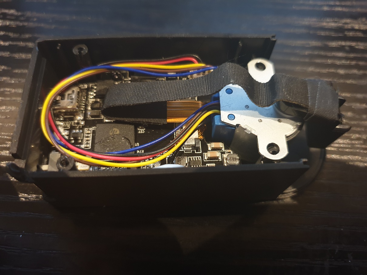

I pulled out the battery and remove the foam pads under it, then there are another couple of screws securing the mainboard.
I pulled out the camera motor and mainboard, under it I removed the wires for the battery then removed the two LED's using pliers (one is on the bottom the other is near the USB power input on the other side).
