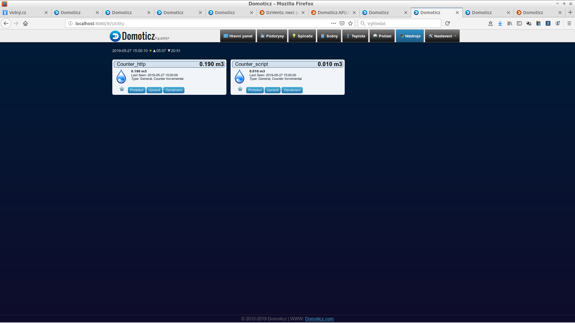

After a couple a minutes I can see this:
JSON updates counter correctly, but updateCounter() function do not add value, but simply store value into counter.
