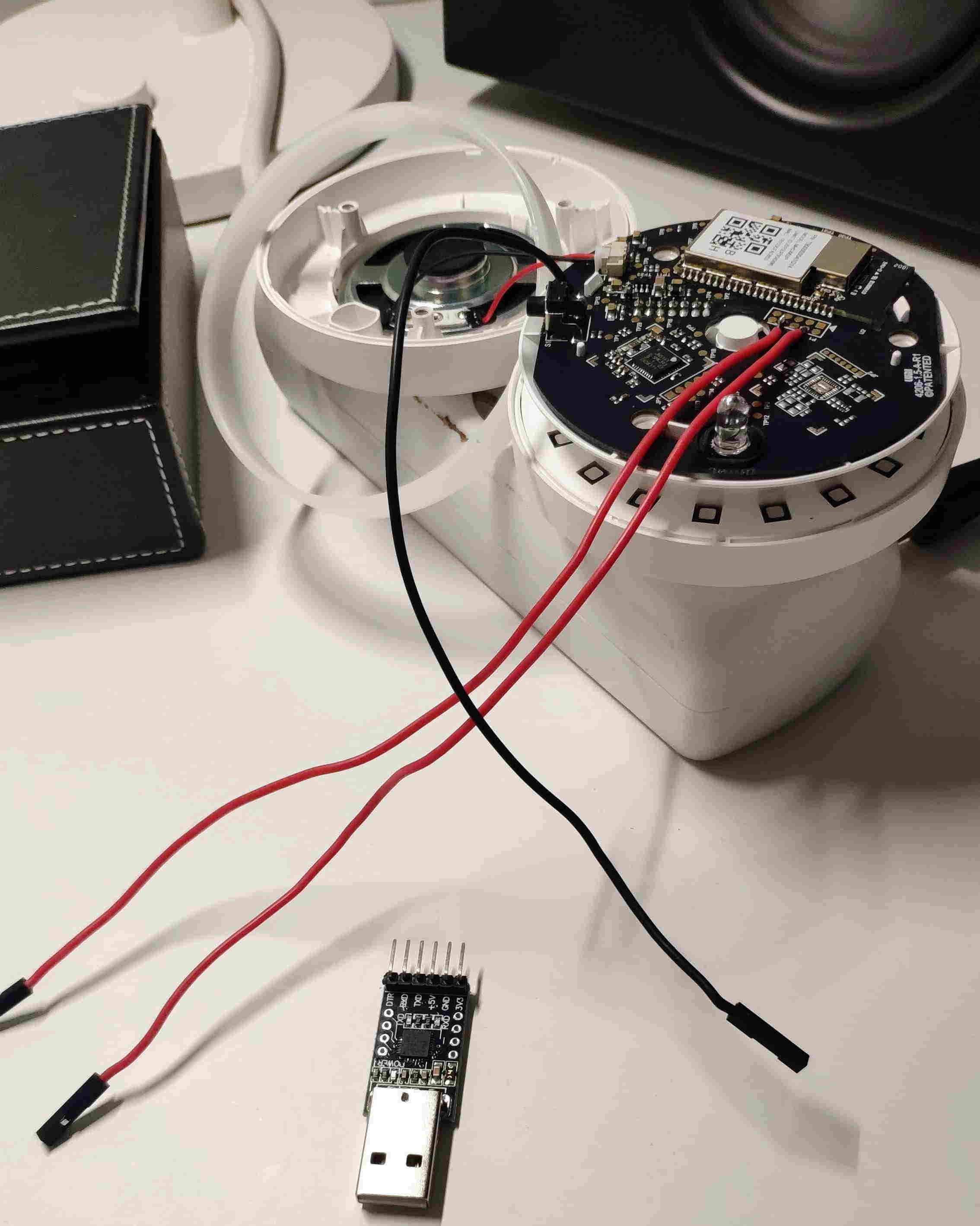

You need:
  • A special bit to open the housing of the gateway.
    I used regular tools...
    It´s called “security bit” .
    Then replace by normal screws of similar size.
    UART to USB tool like CP2102 USB from Aliexpress.
    Maybe the driver to run it.
    PuTTY . A software to send commands via UART to the gateway.
    nmap / zenmap. This software is used to scan the network.
    Soldering equipment
Steps
  • UART and gateway power off.
    Get your gatway running with the xiaomi app.
    Click on the gateway, top right “…” will bring you to settings.
    Click “About”.
    Click 5 times on the white area until the secret menu/developer mode pops up.
    Enable the switch and note or screenshot your password.
    NOTE Screenshot your password!
    Start soldering.
    Connect the blue cable to"GND" on the UART.
    Connect the brown cable to “RXD” (Receiver) on the UART.
    Do NOT connect "TXD".
    Connect UART to Computer.
    Check the device on your device list to find the COM.(Control Panel Devices at Windows )
    If your device doesn´t show the COM number you might need the driver.
    Open PuTTY.
    Select serial and your COM port of the UART.
    Set Speed 115200.
    Don´t open yet.
    Turn on the gateway / connect to power.
    Press open in PuTTY.
    A Window opens.
    You will see the messages of the gateway.
    Wait until the gateway finnished booting.
    NOW Connect the red cable to “TXD” (transmitter) of the UART.
    Now you are able to send commands to the gateway.

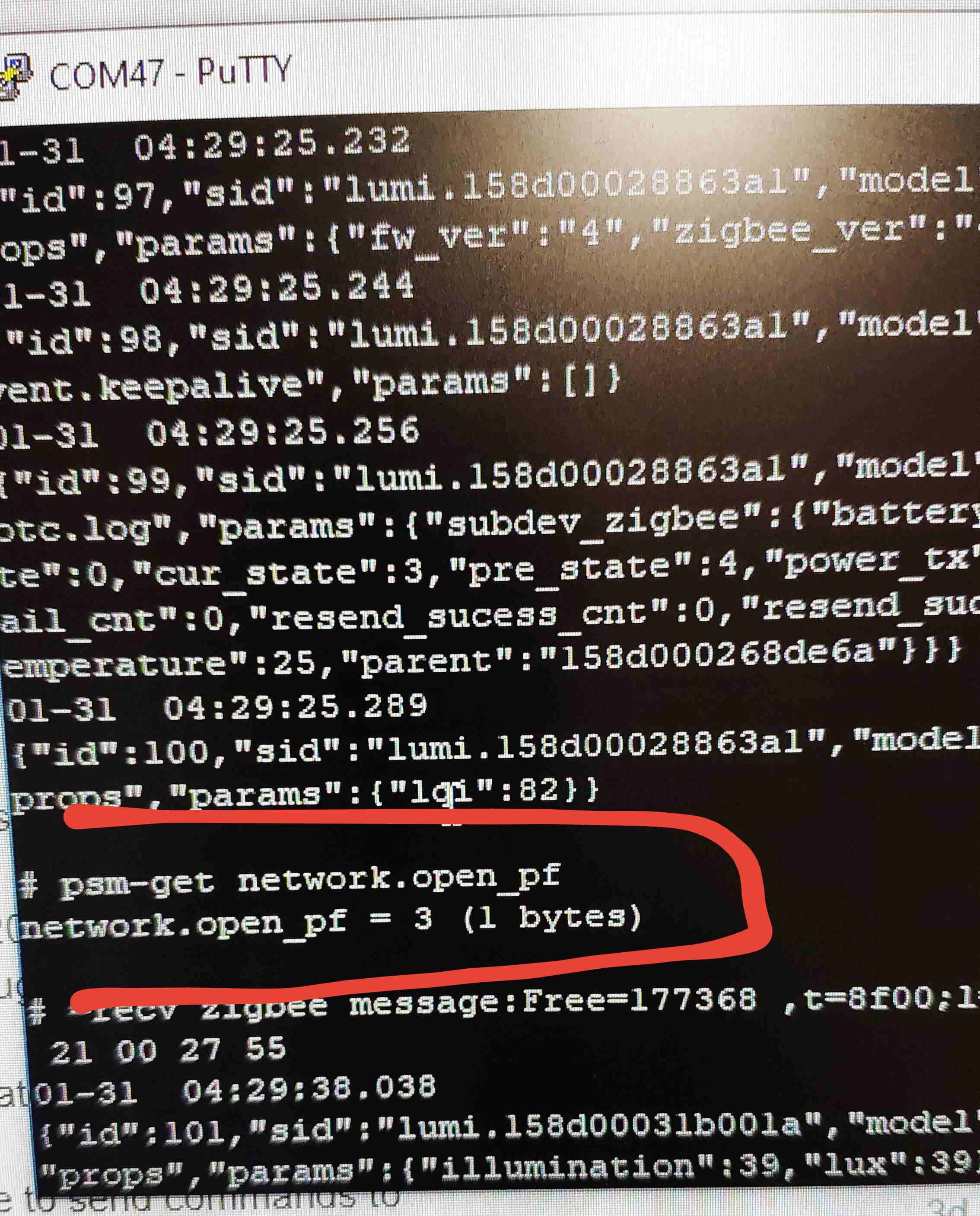

    Press few times enter to see:
Send command:
psm-set network.open_pf 3
send it a few times to be sure.
Check for success with command
psm-get network.open_pf
It will say something like networkopen = 3
Turn gateway off.
Wait. Turn it on again.

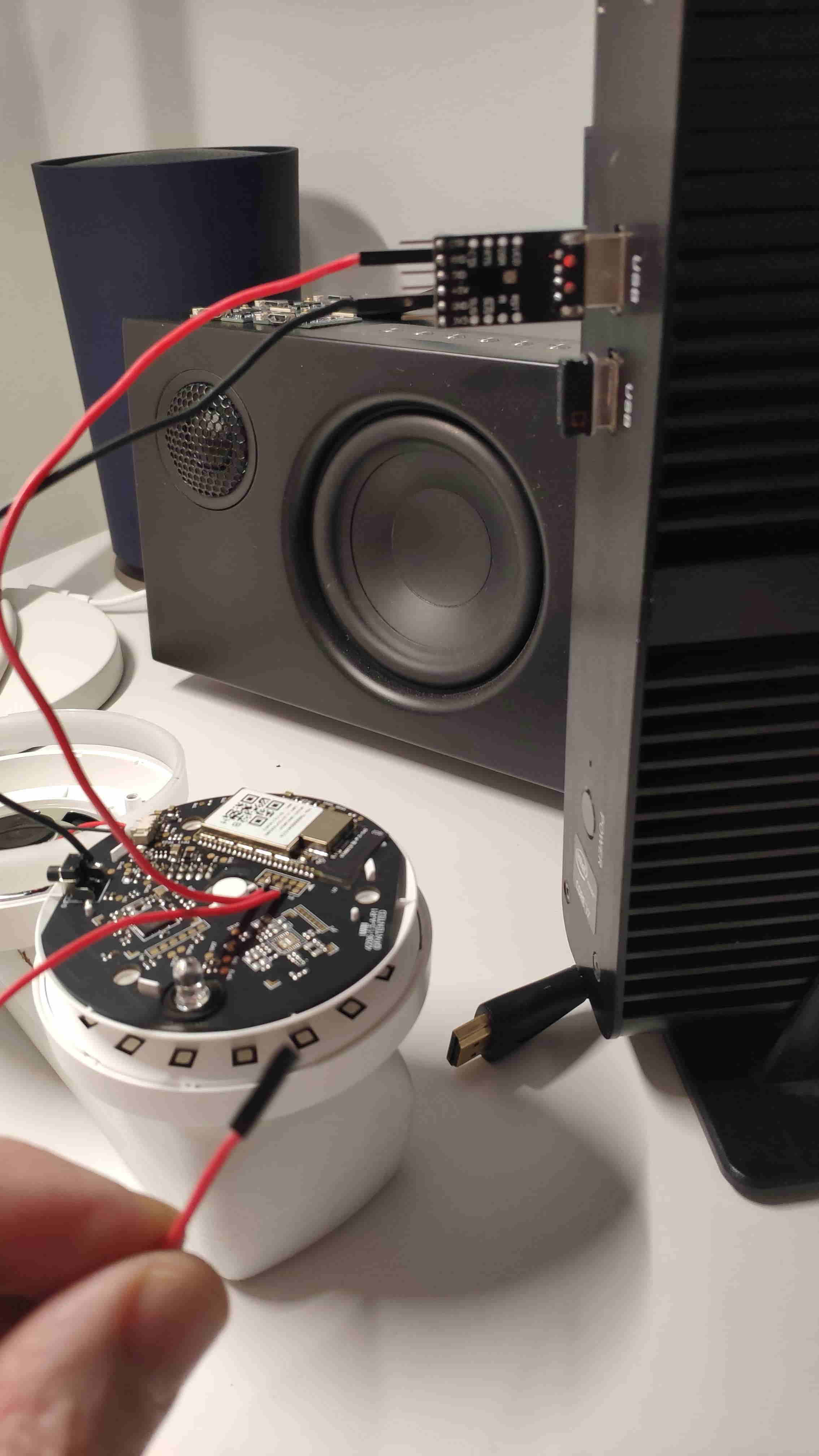

I did this this trick yesterday and now I get the Xiaomi Zigbee Gateway V3 devices to Domoticz!
Please remember to take screenshot of the Xiaomi Gateway password before doing this trick as I for me I cannot open that page at Mi Home app anymore ( maybe not permanent problem, but now I cannot )
