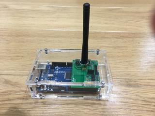

Or you could use this:Dave21w wrote: Sunday 09 June 2019 20:04 I've seen a fair few examples of people building an RFlink using jumper wires and plug in breadboard which is really NOT the way to be connecting RF devices up even for prototyping, even if your lucky enough to get it working that way the performance will be very poor.
from https://www.nodo-shop.nl/en/21-rflink-gateway
The RFLink website http://www.rflink.nl/blog2/devlist gives a very comprehensive list of supported devices.
