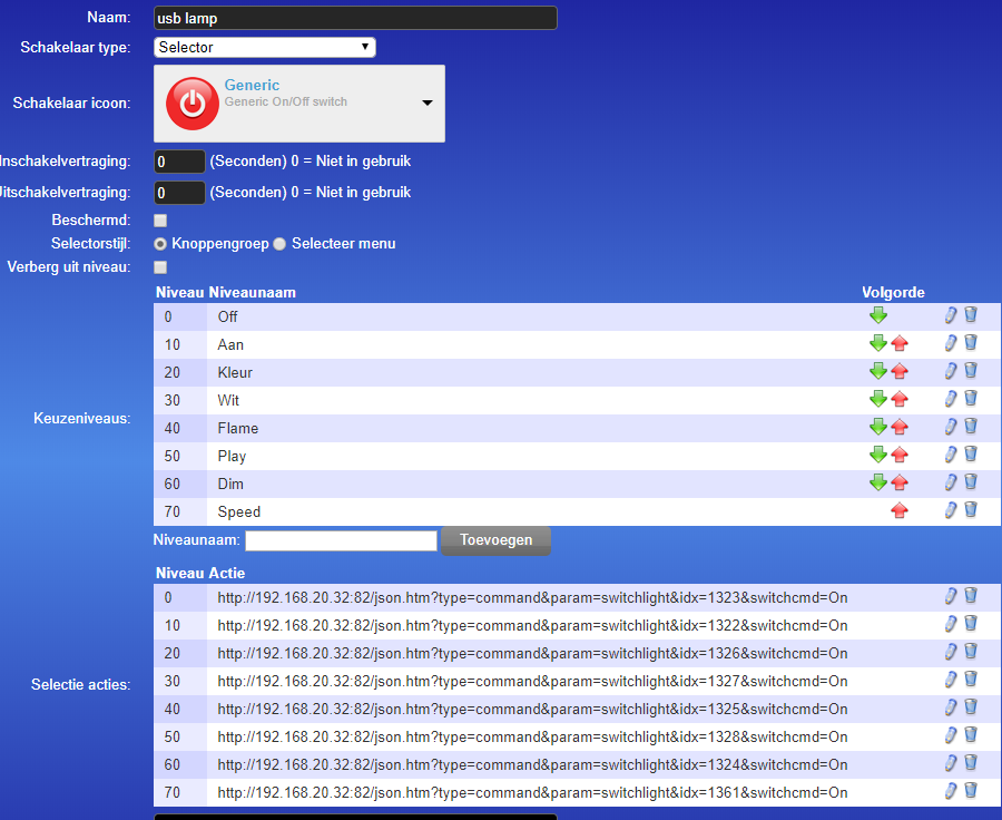

I made a virtual selector "usb lamp" as you mentioned with all the functions as decribed (see attachment)
for the time being i filled the action part with http commands that activates the different (hidden $) switches that give a rf signal to my lidl lamp.
this works for a part...
for example: activate "flame" only works when the lamp is on, so i have to execute two switches for this.
So i need dzvents to solve this and take over the action part, can you give an example for one function, i dont see the match between the action part and the dzvents script...

pvklink wrote: Monday 06 May 2019 19:00 So i need dzvents to solve this and take over the action part, can you give an example for one function, i dont see the match between the action part and the dzvents script...
Is the IP number in the action part your domoticz system ?

Yes, and the devices are (hidden) broadlink switches which send the different rf signals(on for each switch) that i grap from the air with the broadlink plugin
On puts the light on
Off puts it off
Play let the light play different colorscheme's and toggle it pauses it
flame let the light go flikkering like a candle
white turns it back to normal white without flickering
dim dims the device when you toggle it and after the lowest value it start alover again for hight to low (four stages)
Speed is the flicker speed (toggle between two stages quick and slow)
Color toggles between four colors

Re: dzvents rgb broadlink
Post by pvklink »
okay, after a lot off restarts, updates etc it works again, do not know why
The script is working!
But when the lamp is off and i turn on color is does not work. First put the lamp on and then color does work.
So it cant execute two commands
@update: removing .checkfirst in action did the trick

Question 2: can i also call this script from another script and putting the lamp to red without having red as an option in the selector switch ?
Question 3: is it possible to give two items in actions in one line in the selector switch example color 1 or color red
(red =
1. turn the lamp off then on
2. activate the color one time
other colors = groen =2 times, blauw 3 oranje 4, grijs 5, roze 6 paars 7
my tempory solution
            on =    {   devices =    { "usb lamp" }},   -- controller , define as virtual selector Switch with all level as named in action table
        logging =   {   level     =   domoticz.LOG_DEBUG,
                        marker    =   "Lidl"   },
    execute = function(dz, item)
        local triggerDevice_Off    = dz.devices(1323)
        local triggerDevice_Aan    = dz.devices(1322)
        local triggerDevice_Kleur  = dz.devices(1326)
        local triggerDevice_Rood  =  dz.devices(1326)
        local triggerDevice_Flame  = dz.devices(1325)
        local triggerDevice_Play   = dz.devices(1328)
        local triggerDevice_Dim    = dz.devices(1324)
        local triggerDevice_Speed  = dz.devices(1361)
        local function other()  -- you can define whatever actions you need in these functions.
            dz.devices('device1').toggleSwitch().silent().afterSec(4)
        local function dimTo(level)
            Lidl.dimTo(level)
        actions = { Off       = function() triggerDevice_Off.switchOn() return end,
                    Aan       = function() triggerDevice_Aan.switchOn() return end,
                    Kleur     = function() triggerDevice_Aan.switchOn() triggerDevice_Kleur.switchOn() return end,
                    Rood      =
                        return end,
                    Wit       = function() triggerDevice_Aan.switchOn() triggerDevice_Wit.switchOn() return end,
                    Flame     = function() triggerDevice_Aan.switchOn() triggerDevice_Flame.switchOn() return end,
                    Play      = function() triggerDevice_Aan.switchOn() triggerDevice_Play.switchOn() return end,
                    Dim       = function() triggerDevice_Aan.switchOn() triggerDevice_Dim.switchOn() return end,
                    Speed     = function() triggerDevice_Aan.switchOn() triggerDevice_Speed.switchOn() return end, }
        actions[item.levelName]() -- Call required function with key = levelName
pvklink wrote: Tuesday 07 May 2019 20:27 The script is working!
Nice !
What does these lines do?
They are not functional but are a leftover from the previous version.
Can i also call this script from another script and putting the lamp to red without having red as an option in the selector switch ?
Not direct but an option is to create a variable ( type string )and use the other script to set that variable. The content of the variable can be used to trigger any (set of ) action(s) ) you want.
The original script would then look as something like.
            on =    {   devices = { "usb lamp" }, -- controller , define as virtual selector Switch with all level as named in action table
                        variables = { "controlVar" },   -- var, define as type string
                        marker    =   "Lidl"   },
        colors = { rood = 1,
                   groen = 2,
                   blauw = 3,
                   oranje = 4,
                   grijs = 5,
                   roze = 6,
                   paars = 7,
                        Kleur = function(color)
                                    triggerDevice_Kleur.switchOn().repeatAfterSec(0.1, colors[color] - 1) -- 0.1 works for virtual devices and Hue but not for rfLink
                                    return
                                end,
        if item.isDevice then
        else -- item is variable
            for color, number in pairs(colors) do -- check if called with one of the defined colors
                if item.value == color then
                    actions["Kleur"](color) -- call the function with color as parameter
                    return -- ends this script
            if actions[item.value] then -- it was none of the defined colors
                actions[item.value]()   -- but exists in the actions table as key to a function
                dz.log("unknown action requested ( " .. item.value .." )",dz.LOG_ERROR )

Works almost perfect!
One error when selecting Kleur on the selector
2019-05-08 23:05:49.409 Status: dzVents: Error (2.4.19): Lidl: An error occured when calling event handler DZ_usb_lamp
2019-05-08 23:05:49.409 Status: dzVents: Error (2.4.19): Lidl: ...moticz/scripts/dzVents/generated_scripts/DZ_usb_lamp.lua:32: attempt to perform arithmetic on field '?' (a nil value)
                        variables = { "ledlampkleur" },   -- var, define as type string
                        marker    =   "Lidl"   },

pvklink wrote: Wednesday 08 May 2019 12:31 Works almost perfect!
Can you please check this version ?
                        marker    =   "Lidl"   },

After pushing "Kleur" from the selector switch i get:
Do not see why this error occurs. Please check with new script where I added extra log statements. Hopefully that will give enough information to see what is causing the error. This script is also ready for your request to do something for x seconds.
local controlVar = "controlVar"  -- var, define as type string
                        variables = { controlVar },   -- var, define as type string
                        marker    =   "Lidl"   },

Hi @waaren.
Installed my domoticz again ... lot of work
-- broadlink, chromecast,ikea, hue, rfx, p1, zwave, mqtt, nodered and everything seems to be ok now....
I upgraded the script like you said,
And added theo global helper, dont know if i did that right, see below...
	-- global persistent data
	data = {
		myGlobalVar = { initial = 12 }
	-- global helper functions
	helpers = {
		myHelperFunction = function(domoticz)
			-- code
                alertLidl = function(dz, action, period)
                        local controlVar = dz.variables("controlVar")
                        local value = controlVar.value
                        if controlVar.value ~= action then
                            controlVar.set(action)
                            controlVar.set(value).afterSec(period)
                            dz.log("alert requested; controlVar set to " .. action ..
                                    ". It will return to ".. value .. " after " .. period ..
                                    " seconds." ,dz.LOG_FORCE)
                            dz.log("No changed needed; controlVar is already set to " .. value,dz.LOG_DEBUG)
                end,
