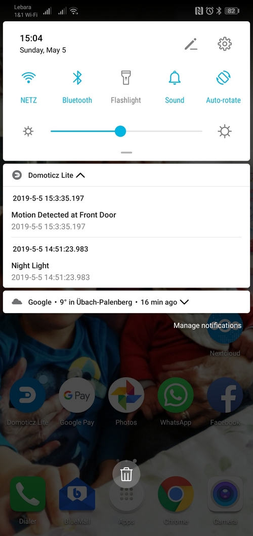

Hi there,
is there an option to add the "current time" into a notification?
Or update a user variable with the "current time" (what could later be used in a notification) when Event was triggered?
Well, i got it to work the way i wanted it too with a dzvents script.
In case someone is looking for this as well:
First i created a user variable called "current time"
Then i created the dzvents script:
local Time = require('Time')
local now = Time()
   active = true,
      devices = {'*'},
   execute = function(domoticz, item, triggerInfo)
     domoticz.variables('current time').set(Time().raw)
In my Blockly notification i used the user variable "current time" as message.
Thanks,
Dennis

i am using the domoticz for android. If i only have 1 notification it shows like ( x minutes ago) but as soon as i have 2 or more the time disappears.
local now = Time()
   active = true,
      devices = {'*'},
