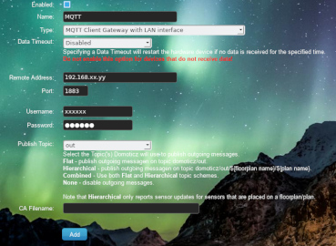

So first step is to create the MQTT hardware device.
If you have installed your MQTT broker on the same hardware device as Domoticz you may use "localhost", otherwise fill in the IP address of the broker.
For security reasons I recommend at least to use a username and password combination. You have to set this in your broker as well.
Domoticz will subscribe to domoticz/in and publish to domoticz/out.
I assume that your MQTT broker (Mosquitto?) is properly installed.
If so you should see a lot of messages published to domoticz/out if you connect to the broker with a suitable client.
One I can recommend is MQTTfx (https://mqttfx.jensd.de).

Reading this thread I don't think this way it is going to work.
However it is quite easy.
In general it is a bad idea to publish messages from external equipment directly into domoticz/in, because the syntax used by the external equipment will not match the syntax expected by Domoticz.
I assume, as I read it, this weather station will transmit a message every 5 minutes and it will look like {"temperature": 28.75, "rain": 0.2794, "windspeed": 0.6628257844249887}. As SweetPants already indicated Domoticz expects something else and it is dependent on the type of sensor.
As I see in the script the weather station gives you 3 sensors:
1. Temperature Sensor (°C)
2. Wind speed (m/s)
3. Rain (mm)
Although that you have the possibility of creating a combined sensor, I recommend to create one virtual sensor for each of the sensors of the weather station. So totally three sensors of the type, resp. Temperature, Wind and Rain. You can create a combined sensor for Wind+Temp+Chill, but in that case you have to calculate the chill. As said not recommended.
I assume that you MQTT broker (Mosquitto?) is properly installed.
