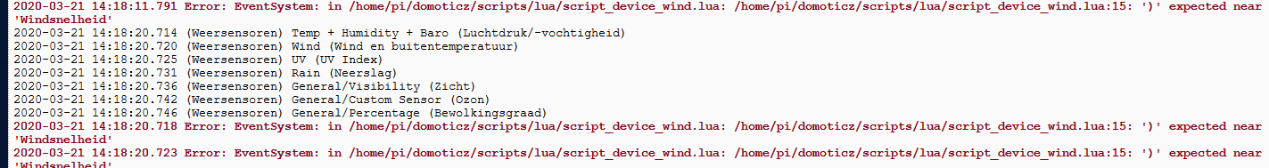

I modified the code like this:
    local function extractWind(wind) --
        t = {} -- declare t as empty table
        for value in wind:gmatch("[^;]+") do -- split string and insert
            table.insert(t, value) -- results in table
        return (t[3]/10), (t[4]/10)
    -- loop through all the changed devices
    for deviceName, deviceValue in pairs(devicechanged) do
        if (deviceName == 'Wind') then
            local windSpeed, gust = extractWind(deviceValue) -- Call function
            print ('Windspeed in ' Windsnelheid ': ' .. windSpeed .. ' m/s')
            print ('Wind gust in ' Windvlaag ': ' .. gust .. ' m/s')
return commandArray
The logs displays:
Knipsel log.PNG (25.83 KiB) Viewed 2409 times
It is undoubtedly very simple but I cannot get it solved :oops:
Help is much needed
Thanks in advance!

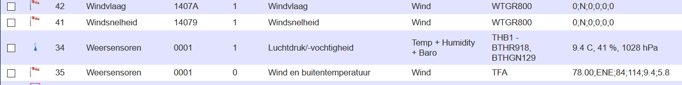

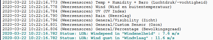

Thank you in the first place for your quick answer!
After changing (deviceName == 'Wind') to (deviceName == 'Wind en buitentemperatuur'), the log shows:
Knipsel log.PNG (15.57 KiB) Viewed 2375 times
Despite this, the Wind Speed and Wind Gust devices are not updated. The bars remain red. Also changing the sensor from the 'wind' type to the 'custom' type does not solve the problem.
Maybe I can ask a supplementary question. I think it must be possible to create a separate sensor with the outside temperature with same script. I tried it like this:

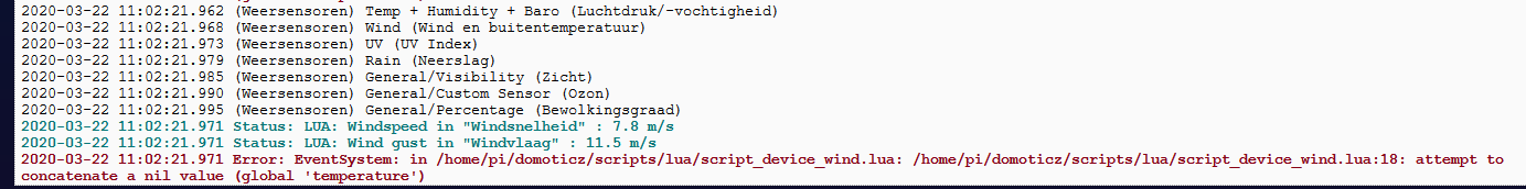

        if (deviceName == 'Wind en buitentemperatuur') then
            print ('Windspeed in "Windsnelheid" : ' .. windSpeed .. ' m/s')
            print ('Wind gust in "Windvlaag" : ' .. gust .. ' m/s')
            print ('Temperature in "Test" : ' .. temperature .. ' C')
return commandArray
This script gives the following error (I don't know how to enter the degree sign):
Knipsel log2.PNG (21.74 KiB) Viewed 2375 times
Thanks again for the help.
Re: Wind speed script
Jan Jansen wrote: Sunday 22 March 2020 11:10 Despite this, the Wind Speed and Wind Gust devices are not updated. The bars remain red. Also changing the sensor from the 'wind' type to the 'custom' type does not solve the problem.
I don't see a command in this script to update a device. It is only sending something to the log.
I think you will do yourself a favorby switching to dzVents scripting if you're already working with Lua in domoticz. dzVents scripts are 100% Lua with a lot of the boilerplate code accessible via easy commands.
