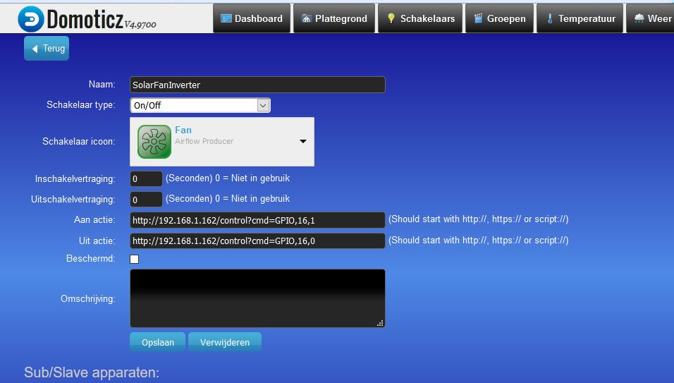

Hi Sum
You are making your life too difficult
Just create a dummy switch, name it after the function of the first relais "Floorlamp?" type is an on/off switch
The goto the switch in the switch page and put in the url's
- Capture.JPG (65.04 KiB) Viewed 8401 times

Re: How to read/set GPIO on ESP8266 with ESP Easy firmware?
I don't know how you get to that screen showing that form. First I do this:
Then I do this:
I don't see anything like in your screen. ?!
Then I do this:

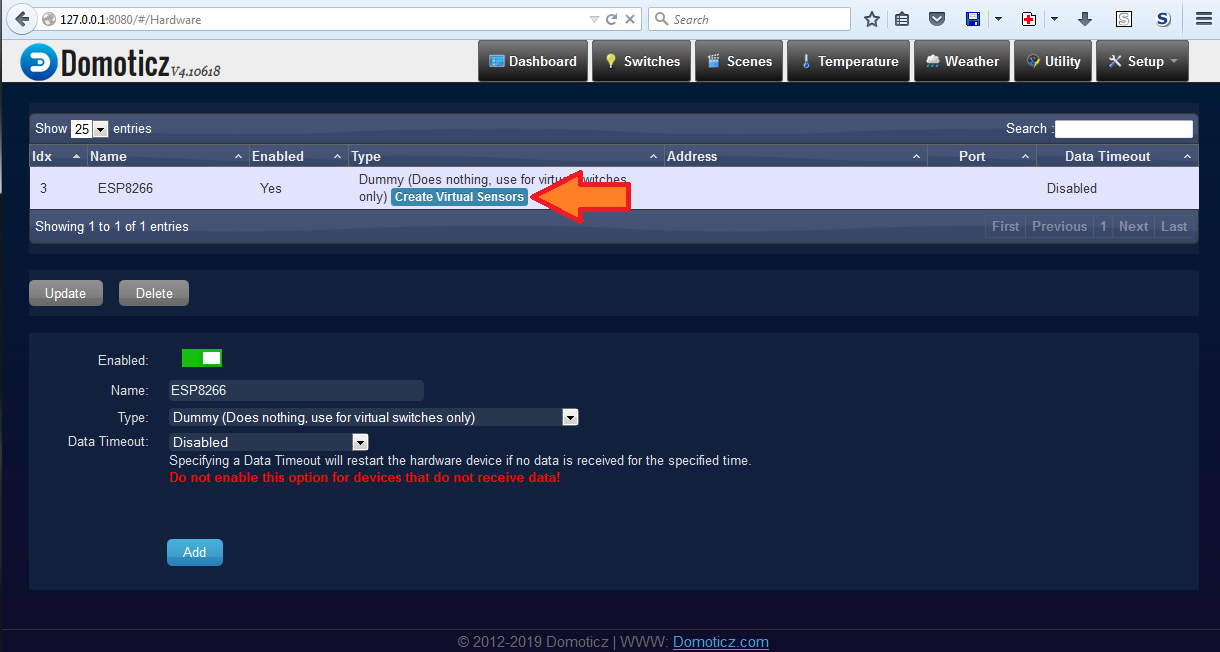

Where do I CREATE "Dummy Virtual Sensor" ?!
On this page: http://127.0.0.1:8080/#/Hardware ?
If it is on that page, then what Type? I do not see "Sensor" or "Virtual Sensor" in the Type drop-down list !!!
The only place I see Virtual or Dummy is "Dummy (Does nothing, used for virtual switches only)"
SumGuy
- Posts: 10
- Joined: Wednesday 24 April 2019 15:06
- Target OS: Windows
- Location: Canada
Ah...
I did not notice that "Create Virtual Sensors" was a clickable item on the Hardware screen. And I wouldn't have thought that I would have to click it anyways, because it refers to "sensors" and not a switch. I would suggest a different way to handle this - it was not intuitive.
