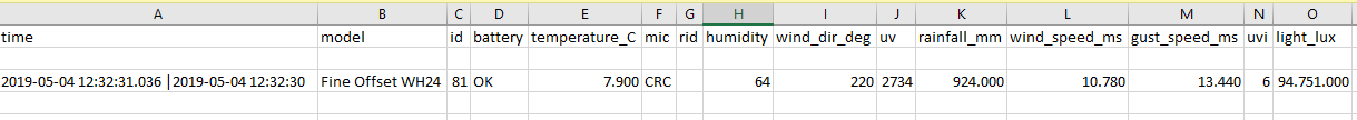

kfeelders
- Posts: 25
- Joined: Tuesday 23 April 2019 21:56
Re: Fine Offset WH24 weatherstation via RTL_433 only shows temp./humidity
Thanks gizmocuz,
but the headers presented by the Fine Offset WH24 are already known in Domoticz, see picture (below) of the cleaned up
"WH24 data.xlsx" i attached earlier.
I will take a look at RTL433.cpp/h
Kees
Thanks gizmocuz,
Kees
- WH24 Headers.png (8.25 KiB) Viewed 5669 times

kfeelders
- Posts: 25
Looking at rtl433.cpp
(https://github.com/domoticz/domoticz/bl ... Rtl433.cpp) ,
do i understand correctly that presently we "look" for:
time (start line 107),
unit
channel
battery
temperature_C
temperature_F
humidity
pressure_hpa
rain
rain_total
depth_cm
depth
windstrength wind_speed
average
winddirection wind_direction
direction
wind_gust
gust
moisture (stop line 316)
in the CSV header / data files on line 33 etc.?
As can be seen in my post above (10 may 16:56) in the tabel the WH24 presents date under the headers:
time (ok)
model (ok)
id (ok)
battery (ok)
temperature_C (ok)
mic (not included)
humidity (ok)
wind_dir_deg (not included)
uv (not included)
rainfall_mm (not included)
wind_speed_ms (not included)
gust_speed_ms (not included)
uvi (not included)
light_lux (not included)
Does that mean that RTL433.cpp needs to be modified to include also those "not included" headers?
thanks, Kees
time (ok)
model (ok)
id (ok)
battery (ok)
temperature_C (ok)
mic (not included)
humidity (ok)
uv (not included)
uvi (not included)
thanks, Kees
