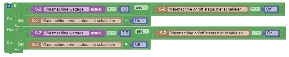

This is my block
and if the status wasmachine( dummy) go off i get a notification the wasmachine is ready
I get one notification
works great for me
Gerwin
works great for me
Gerwin
- blockly.jpg (59.78 KiB) Viewed 2141 times
