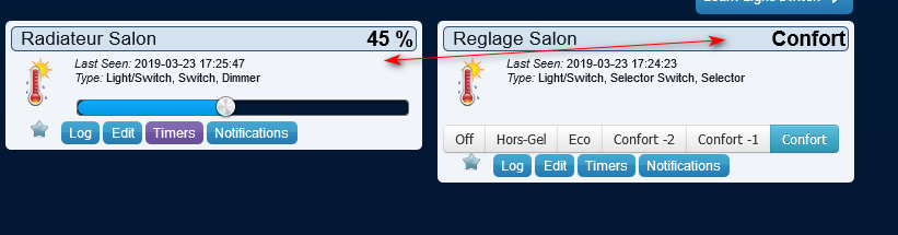

I have a Qubino Zwave device to drive my electric heater (ZMNHJD1)
This one act as a dimmer so I have a block script to easily set the level with button instaed of value > this works well
But if I change directly on the device, I am out of sync with my selector
On this example I set the device to 45% and so I should be on CONFORT-1 on the selector
Unfortunately it seems to be a one way street, from selector to device but no in the other way
Is there any mean to refresh the status of a virtual selector with the status of a real device
Thanks in advance for your idea

ciberyan wrote: Friday 12 April 2019 8:36 I have a Qubino Zwave device to drive my electric heater (ZMNHJD1)
See below dzvents script; it should work both ways.
