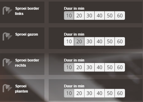

OK, i have four garden switches which i can put on/off. Each garden switch also has a corresponding switch (with levels 10, 20, 30-60 minutes)
So when activate a garden switch it uses the data of the corresponding switch(with levels).
All this functioned well. Till i stop a switch before the .aftermin was finished! My system went crazy...
I created a new script (alternative for the aftermin function) but that did not work (thats for later to learn from it)

i added a screendump (part of my dashticz)

pvklink wrote: Tuesday 09 April 2019 19:45 OK, i have four garden switches which i can put on/off. Each garden switch also has a corresponding switch (with levels 10, 20, 30-60 minutes)
So i get back to the original script i include in this post.
I added: device.cancelQueuedCommands() after device.switchOff()
Now everything seems to work well !, i can even stop my switch with pending timers (aftermin) without problems.
