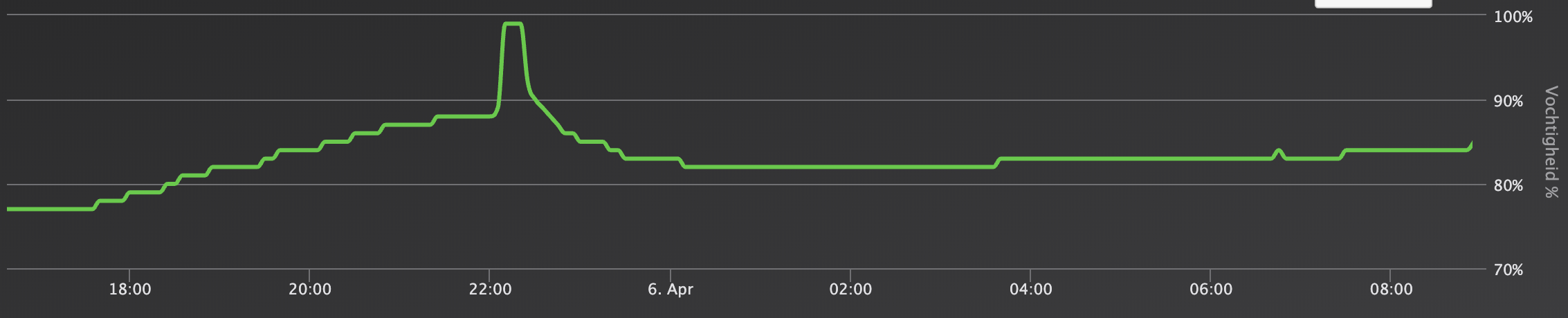

Just bought 2 XT300 soil moisture sensors for my plants.
The % humidity keeps rising instead of becoming less during the time. When I add water, I see a peak, some time later a drop and then again it starts rising.
Both the sensors acts the same.....
Any thoughts on this??

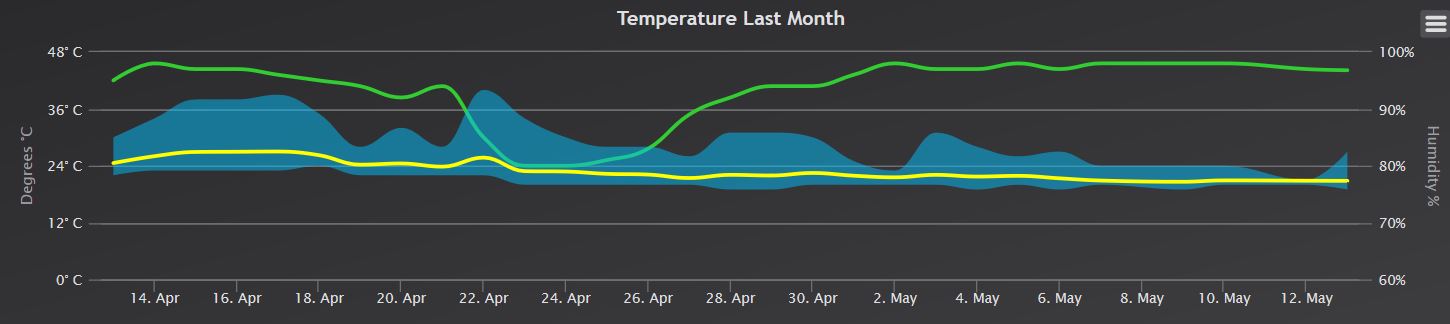

This is what one of my sensors show, guess my wife was away the 24'th.
"seems i snipped it a bit short, green is moisture."

Hi Nettime,
Thanks for the response. Lately the line seems to make more sense, the range is between 95% full wet, and 70% for dry.
I dont onderstand your trend. Slowely raising grom 24th april, and then a steady line. Do you water your plants daily?
