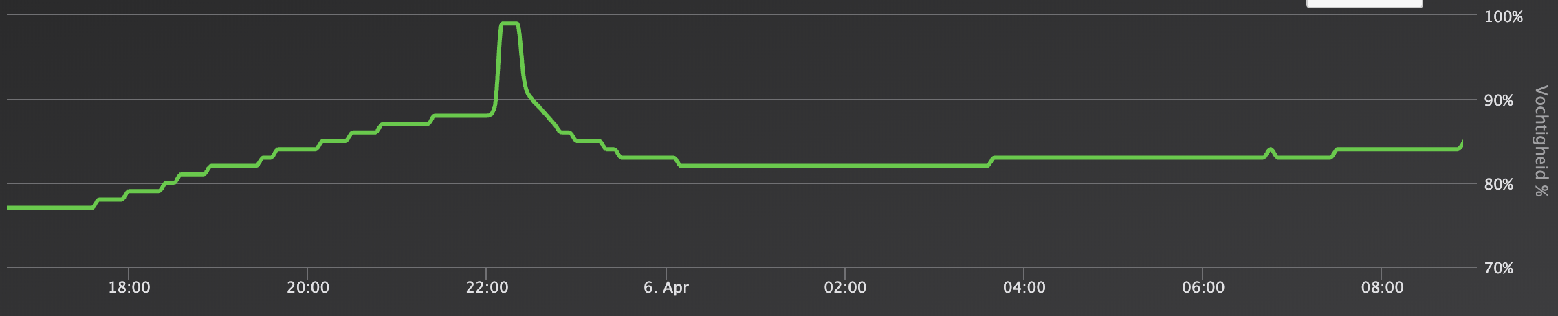

Just bought 2 XT300 soil moisture sensors for my plants.
The % humidity keeps rising instead of becoming less during the time. When I add water, I see a peak, some time later a drop and then again it starts rising.
Both the sensors acts the same.....
Any thoughts on this??
Moisture % XT300 keeps rising

Re: Moisture % XT300 keeps rising
This is what one of my sensors show, guess my wife was away the 24'th.
"seems i snipped it a bit short, green is moisture."
Hi Nettime,
Thanks for the response. Lately the line seems to make more sense, the range is between 95% full wet, and 70% for dry.
I dont onderstand your trend. Slowely raising grom 24th april, and then a steady line. Do you water your plants daily?
