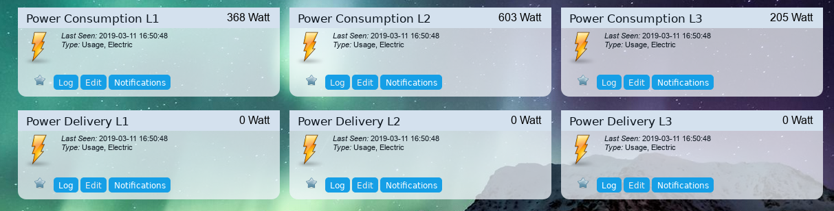

I use the same 3 phase Landis&Gyr E350 smart meter.
In the latest stable release 4.9700 you will receive 5 values from that meter. (Total Electricity Usage, Gas Usage (if you have a gas meter connected) and the 3 Line Voltages) In the beta release (I run 4.10547) you will receive more information, such as the consumed power from the grid for each phase and if you are the lucky owner of solar cells you will also see the delivered power to the grid.
So if you want to see it separately you have to upgrade to the latest beta.
Screenshot_Power Usage.png (274.34 KiB) Viewed 824 times

Thank you for your reply! I updated my domoticz to the latest beta version, and i can see the usage per phase now. :D
