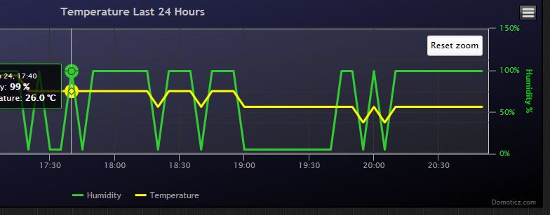

I'm not sure. I have put the sensor so that the white line is at the level of the soil/earth in the pot, I still get 5% and 99% most of the time, regardless if it's dry or watered.
If a place the sensor outside the soil completely, something strange happens. See attached image.
I can buy that the sensor is not working well, if not put properly into the earth/soil.
BUT, I can't see why the temperature sensor should be affected by that, or vice versa?
As you can see in the image, each time the humidity drops from 100% to 0%, it seems like the temperature is dropping some degrees at the same time.
But at the next interval the sensor sends it's data, the values are back again.
Is the temperature data causing disturbance to the moisiture data? Maybe vice versa?
I should try this with rfxmngr also.
I'm using Domoticz V1.1811 on Raspberry Pi (latest updates), and RFXTrx433 USB, firmware version 76.
I'm having the sensor really close to RFXTrx433, one meter approx. and getting readings with regular intervals.
