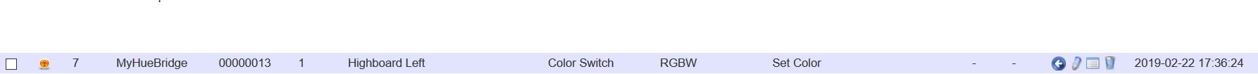

The The highboard Left has the IDX 7:

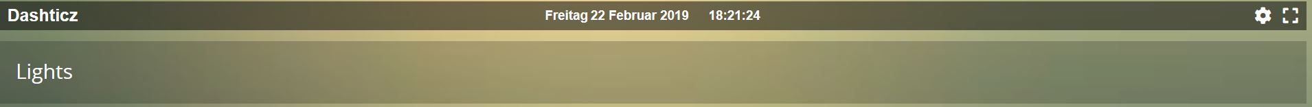

Using domoticz IF i can switch on/of but in inside the Dashticz IF it does not even show-up (except for the group "Lights"):
