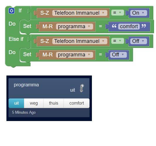

hi all,
i have a selector dummy switch. the selectors are "uit", "weg", "thuis", "comfort".
can i set the selector automaticly to another "selector" when for example a light switches on?
in selector the off function wil work, but the switch to "comfort" doesn't work. why?

Hi, try replacing the text block "comfort" with:- <Level %> Block and the appropriate value of your selector (40?).

You are using the wrong off block .use the same as comfort and type off in the block

StanHD wrote: Saturday 16 February 2019 17:28 Hi, try replacing the text block "comfort" with:- <Level %> Block and the appropriate value of your selector (40?).
Sent from my SM-T820 using Tapatalk
that did the trick! thanx. (i feel dumb :D )
