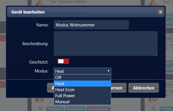

I am able to set the mode manually on domoticz/utility and it's also accepted by the device, but I'd like to create some switches and/or events that use this feature.

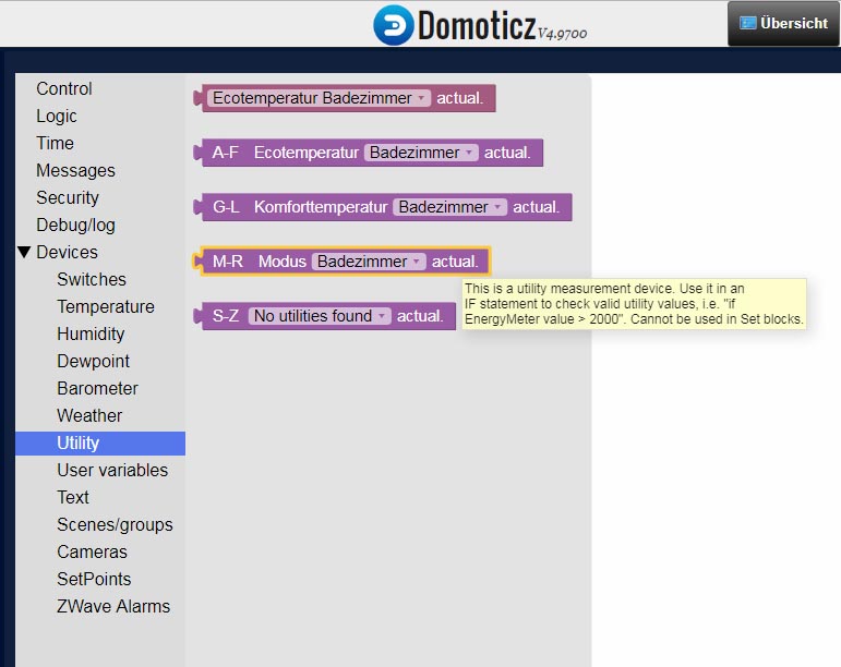

But Blockly says following:
Does anyone know, what I can do to get the Thermostat Mode easy switchable? Is it possible without programming, or do I have to learn lua?

Hey,
I also have a problem with that, but I did not know what was going on. I have similar to yours hardware configuration.
It's good that you pointed out that this block is read-only.
It looks like control "Thermostat mode" can be only by LUA or dzevents, but I do not know much about it.

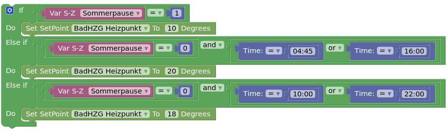

After some mind works :lol: i did this solution that saves battery and utilize blockly.
The first blocky checks outer temperature from my weather station and marks that in a variable.
For every room with z-wave heating regulator (Eurotronic spirit here) the blockly checks if heating is required and used a timed scheme then.
Further idea is to use the summerbreak variable as away switch, while holidays ;)
Solderbro
