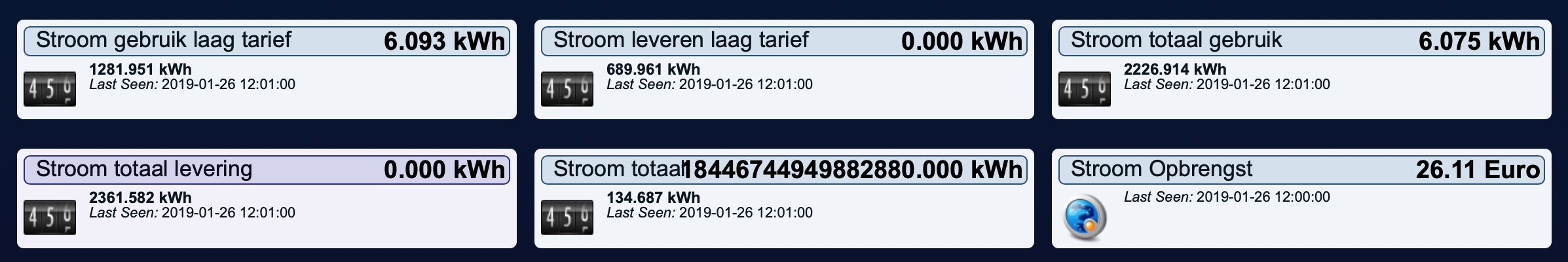

I have 2 virtual counters, number 1 "stroom totaal verbruik" with IDX 74 and number 2 "stroom totaal levering" with IDX 75
I use the dzVents code:
	Combinetest (dzVents 2.4.1)
	on = { timer = { "every minute at daytime" , "every minutes at nighttime" } },
	execute = function(domoticz, _)
		domoticz.devices(78).updateCounter( 1000 * ( domoticz.devices(75).counter - domoticz.devices(74).counter ) )
But the output virtual counter "Stroom totaal" with IDX 78 gifs me strange numbers?
What to do to get it correct?

Knibor wrote: Saturday 26 January 2019 12:12 But the output virtual counter "Stroom totaal" with IDX 78 gifs me strange numbers?
Your "levering" is more then "verbruik" that makes that the outcome of calculation is negative and the device type you picked for "totaal" is not designed to receive negative values (it uses unsigned integer)
If you switch to device type managed counter you can display negative values. But dzVents needs a (minor) update to be able to handle this type.
I will send you an updated device-adapter to test via PM and if OK I will create a PR for it.
