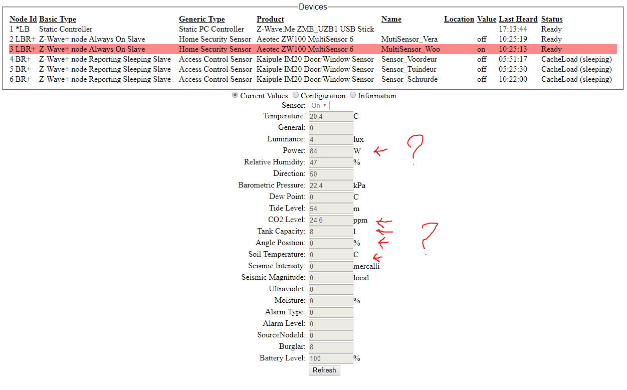

But first things first. My devices list counts over 150 devices after i cleared it yesterday. So i wend deeper in domoticz to shed some light on the matter but when i found the raw data of a node i got confused. I have a MultiSensor 6 that shows a lot more data than it should. I do not own a:
- Power meter
- Tank capacity
- Angle position
- Soil Temperature sensor
Can someone explain to me what is happening here?

'Found' the problem. Sensor firmware seemed to be bugged. After un-pairing every device in my network ive started upgrading the firmware to the new version. Rebuild the full network, with a secure key (Not the default one) did the trick!
