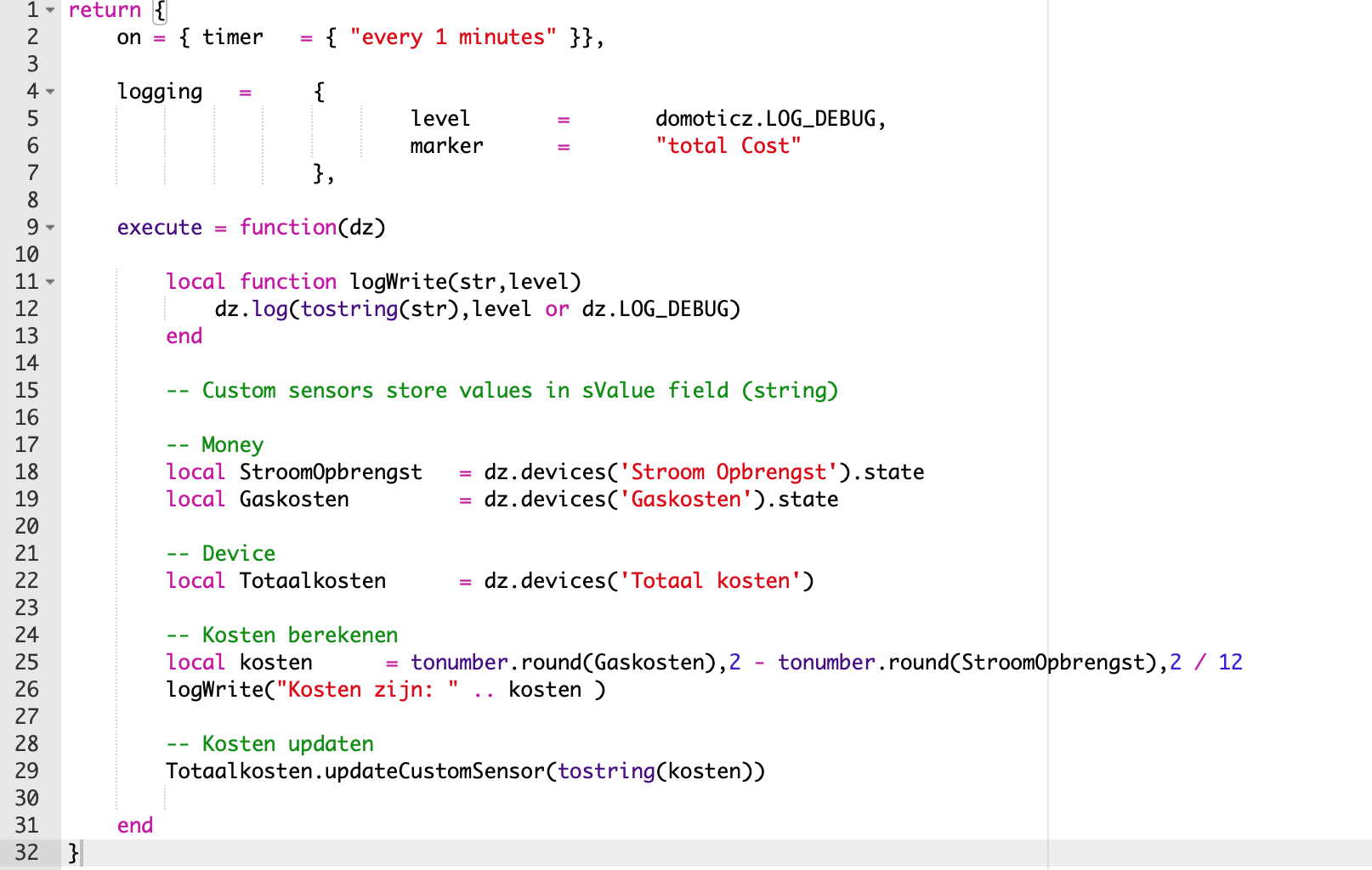

Thanks for the code, it works perfect. I divide the reading though 12, so I get the month cost.
The only thing is that I have now 4 digit behind the "dot"
I tried to round the reading on 2 digit, but no succes. The script was showing no error in front of the script line, but it didn't give me an correct output.
Can't find in the manual how to do this.
Schermafbeelding 2019-01-12 om 15.48.56.png (226.29 KiB) Viewed 1197 times
Re: Offset Gas counter
Knibor wrote: Saturday 12 January 2019 15:49 The only thing is that I have now 4 digit behind the "dot"
try this
    on = { timer   = { "every 1 minutes" }},
    logging   =     {
                            level       =       domoticz.LOG_DEBUG,
                            marker      =       "total Cost"
    execute = function(dz)
        local function logWrite(str,level)
            dz.log(tostring(str),level or dz.LOG_DEBUG)
        -- Custom sensors store values in sValue field (string)
        -- Money
        local StroomOpbrengst   = dz.devices('Stroom Opbrengst').state
        local Gaskosten         = dz.devices('Gaskosten').state
        -- Device
        local Totaalkosten      = dz.devices('Totaal kosten')
        -- Kosten berekenen
        local jaarKosten       = tonumber(Gaskosten) - tonumber(StroomOpbrengst)
	local maandKosten      = dz.utils.round(jaarKosten / 12),2)
        logWrite("Kosten zijn: " .. maandKosten )
        -- Kosten updaten
        Totaalkosten.updateCustomSensor(tostring(maandKosten))

Thanks for the script.
I changed the line to
local maandKosten = dz.utils.round((jaarKosten / 12),2)
Yes it works!
