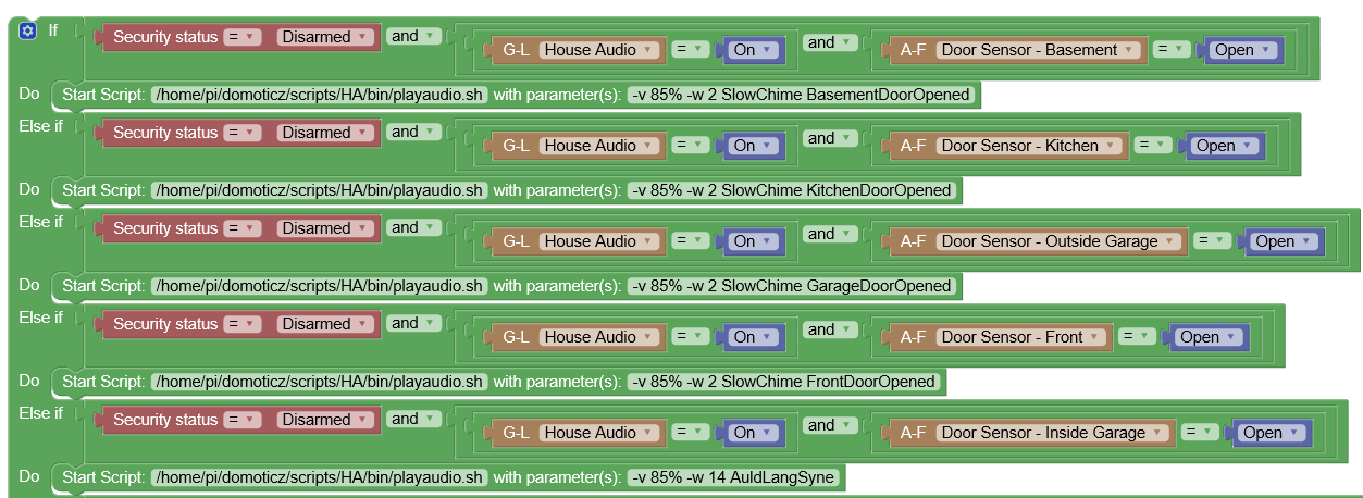

My project was to have my doors play different holiday music clips when they were opened. So, I ditched my legacy security system and hooked my door contact sensors up to a Raspberry Pi. I then connected powered speakers to the 3.5mm audio plug on the Pi and called the script in Domoticz Events (Blocky) to trigger sounds when the doors open. This version of the script has options for volume control, audio delay between playing sound files and plays the list of arguments as audio files. If an argument of a filename isn't present or isn't valid, it plays the default sound.
Blocky Capture.PNG (85.22 KiB) Viewed 2099 times
