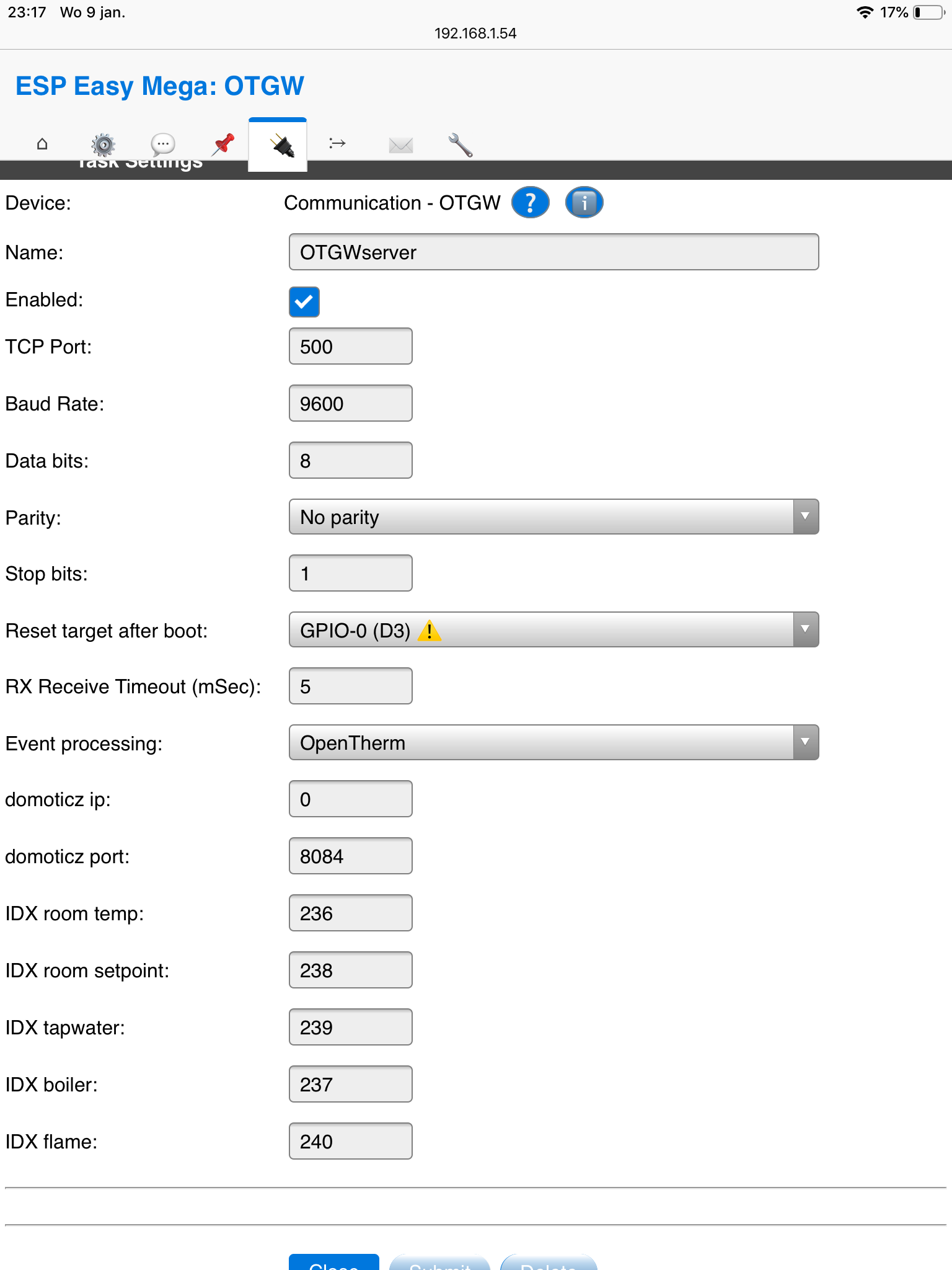

So here my weekend project was born. Let domoticz do the same as otmonitor does. This is how;

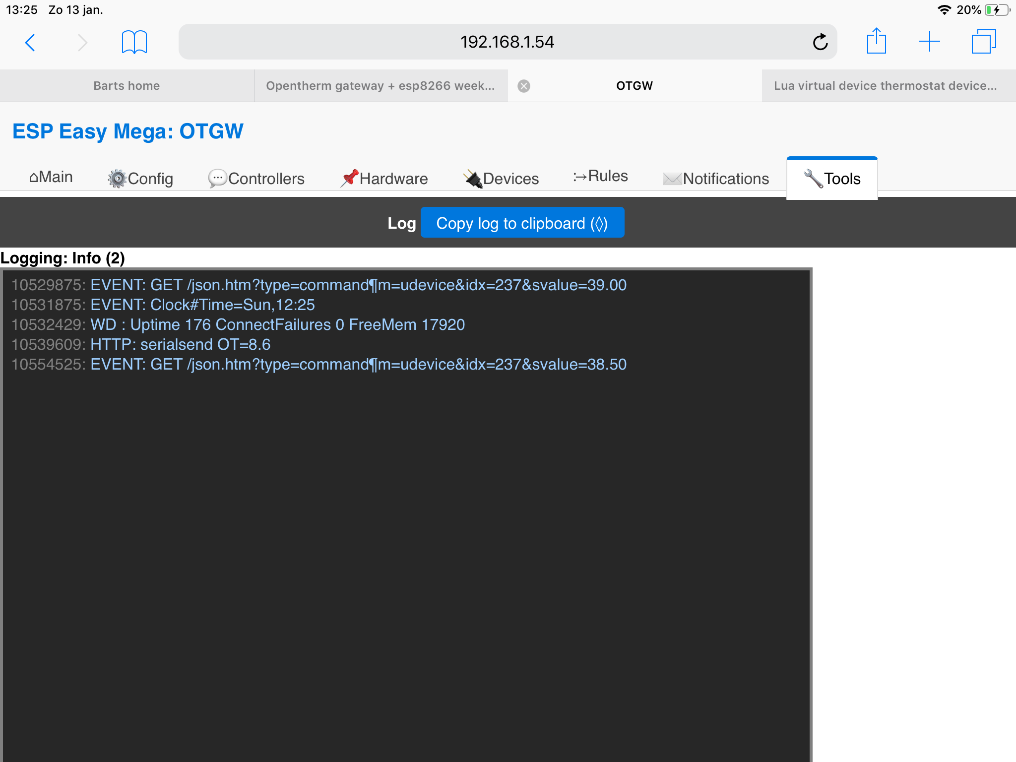

The plan is that the ESP is going to parse all the opentherm codes and put the all the sensor data in its dummy sensors. The ESPeasy firmware takes care of sending all the data to Domoticz. Bonus with this method is that i can use domoticz and otmonitor at the same time.
1- First step is to change the ser2net ino from the easyesp firmware. I added some code to parse the opentherm data and create events in the ESP8266. I had never done this so this took some time with trial and error.
2 - Second step make some rules in espeasy to add the parsed data in the corresponding dummy sensors. This is a standard procedure and was easy to do.
3 - Third step was to create virtual sensors in domoticz so that the esp8266 transfers the data to domoticz.
4 - fouth step was to make a virtual setpoint device in domoticz and send the new temperature setpoint to the esp8266 so that the esp8266 can send a serial command to the OTGW setting a temporary temperature. This was the most challenging part becouse i had to make a lua script in domoticz so send a command to the esp8266.
Its now sunday and i have got three values in domoticz; room temperature, room setpoint , boiler temperature and a setpoint temperature thermostat.
It is working for a few hours but it look promising, its the first time that i can set a the therostat from domoticz!
I will put the codes from the ser2net.ino , the lua script, and the esp rules in my next post maybe someone who has more coding skills can optimize them. If not, for me it is a nice workaround to get opentherm working without any errors in domoticz.

Here's the first part of my project. The INO code from the easyesp firmware. I made a new firmware.bin so that you can download it on the esp8266.

A status update.
Still working to make the program easy to use. I made a screenshot from the esp8266 firmware.
The only thing that you have to do is make virtual sensors in domoticz.
Once this is done you only have to put the corresponding idx numbers in the esp configuration.
This weekend I will add more sensor data in the firmware. Eventually I will put all data from the opentherm gateway in the firmware.

There is. On the esp at the “tools” “advanced” tab you can set logging options. Set the “web log level” to “info”
Now you can see the data that the esp is sending to domoticz. Look at “tools” “log”.
After a minute or so you should see things like in my attachement.
