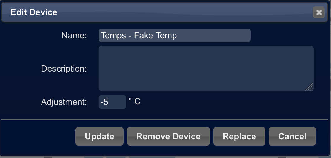

I have documented that in an Issue under the domoticz github , when a Sensor is created from the python plugin framework, the adjustement doesn't work.
https://github.com/domoticz/domoticz/is ... -441357383
Here is a plugin.py creatin a fake temperature sensor and updating the value to 25°
If in domoticz you set an adjustement of -5° you never get this adjustement in consideration. Same for all sensors like Humidi, Pressure ...
Temperature adjustement doesn't work, when it is a Python Plugin device
