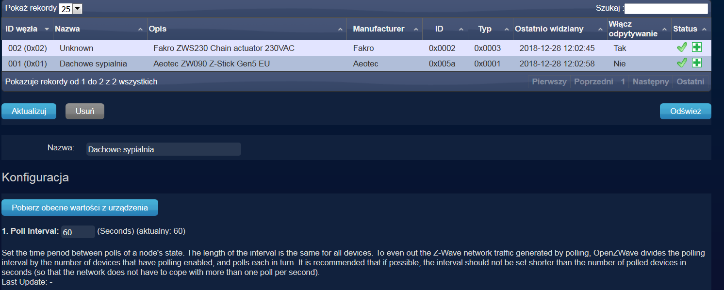

@Antoine How did you get Fakro blinds working with Domoticz? I have Aeon Z-stick gen5 up and working in Domoticz and now I'm struggling to open and close my blinds but to no avail. (I think) I have added one of my blinds to the stick. It is visible on the Hardware/Setup page but missing from Devices.
What have I done wrong? How do you add Fakro blinds to Domoticz?
Ok. I got it working. The only problem is that they were not recognised correctly. As it is seen on the screen shot one is a chain actuator the other (not on the screen shot) as unknown but both working
