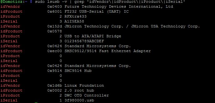

Err actually yes come to think of it, my Pi only starts up from the SD card, everthing else runs from a 32GB SSD via USB, this bit obviously works as it wouldn't boot otherwise.
Here is what i see:-
USB List.jpg (40.91 KiB) Viewed 362 times
