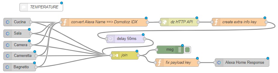

3rd option: use nodered with node-contrib-alexa-home-skill and create the flow you need within these device capability option:
- Lights: ON/OFF/DIM (adaptable for shades and rolling shutters)
[HA-Bridge does the same]
- Thermostat: Set Temp, reat Temp, increase/decrease Temp
- Smart lock (Lock/unlock)
- Temperature: Read Temperature device
I've already created 2 flows for reading rooms temps and set a setpoint
- nr_termostato.jpg (23.08 KiB) Viewed 3239 times
- dzAlexaTempFlow.jpg (42.16 KiB) Viewed 3239 times
