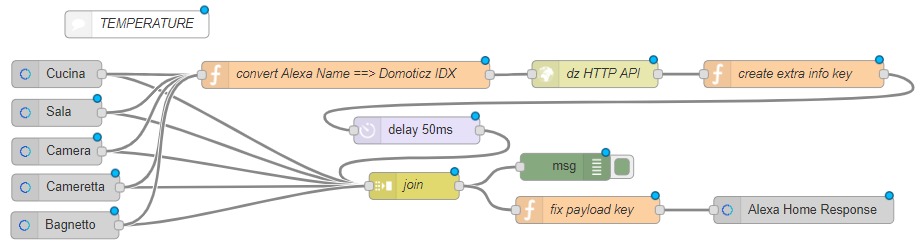

Ciao,
I found a way to have Alexa access Domoticz Temp sensors and speaks.
To do so you will need: there is no cloud... the web site it is only needed to create device aliases, but all requests are only locally executed
than the flow will looks like the following
each device has been configured on the web site, than it is converted into a HTTP request and send back to alexa with the T value
The command is:
"Alexa, what's the temperature in <device>"
"Alexa, quale è la temperatura in <device>" (in italian :P)
it works like a charm! :P :P

SURE!
here it is
change the node that reflect the assignment between the device and the domoticz IDX (will find mine inside)

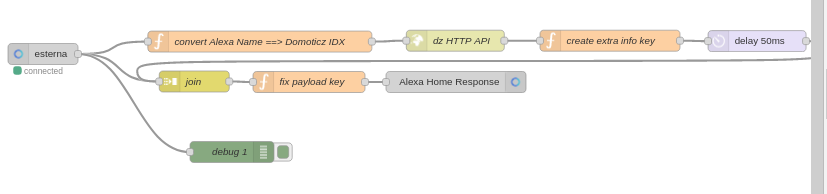

I wanted to have alexa read the energy and outdoor temperature sensors vocally , the system that @emme uses in the post above would be interesting but it doesn't seem to work ; I also put debugs in the process but it doesn't seem to activate,i don't want to use cloud services .I have node-red 3.0.2 on docker [/attachment]

frank666 wrote: Sunday 04 December 2022 19:14 I wanted to have alexa read the energy and outdoor temperature sensors vocally , the system that @emme uses in the post above would be interesting but it doesn't seem to work ; I also put debugs in the process but it doesn't seem to activate,i don't want to use cloud services .I have node-red 3.0.2 on docker [/attachment]
For me the flow works perfectly. Have you password on your domoticz? If so, try to put it into "dz HTTP API" node in "use authentication".
If not, try to put a debug node after each node and tell us what messages you have.

I solved by having nodered read the MQTT messages .Thanks
