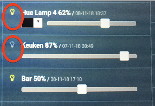

I'm working on a Lenovo TAB 10 tablet, in general it is really looking good, I'm getting a nice dashboard.
But I would like to get bigger icons, zee picture, how is this possible?

I found this myself:
.far.fa-lightbulb:before{
    font-size: 24px;
.fas.fa-lightbulb:before{
    font-size: 24px;
but that doesn't change the size of the icons :-(

rgroothuis wrote: Thursday 08 November 2018 21:29 I found this myself:
    font-size: 24px;
    font-size: 24px;
Try something like:
.block_381 .fas {font-size: 45px !important}
.block_381 .far {font-size: 45px !important}
.block_381 .col-icon { width: 50px !important}
.block_381 .col-data { width: calc(100% - 55px) !important}
This changes the font size, the width of the icon part, and the width of the data part for device 381.
if you remove 'block_381' from all four lines then most of the icons will become bigger.
Instead of .fas or .far you can also choose a specific icon, like .fa-lightbulb

Lokonli wrote: Thursday 08 November 2018 22:36 Try something like:
I tried the above, both the blocks as well as .fa-lightbulb but no result. It is probably me that doesn't understand the way it works.
Any other suggestions / working examples? Of would I use the .fa-lightbulb ?
