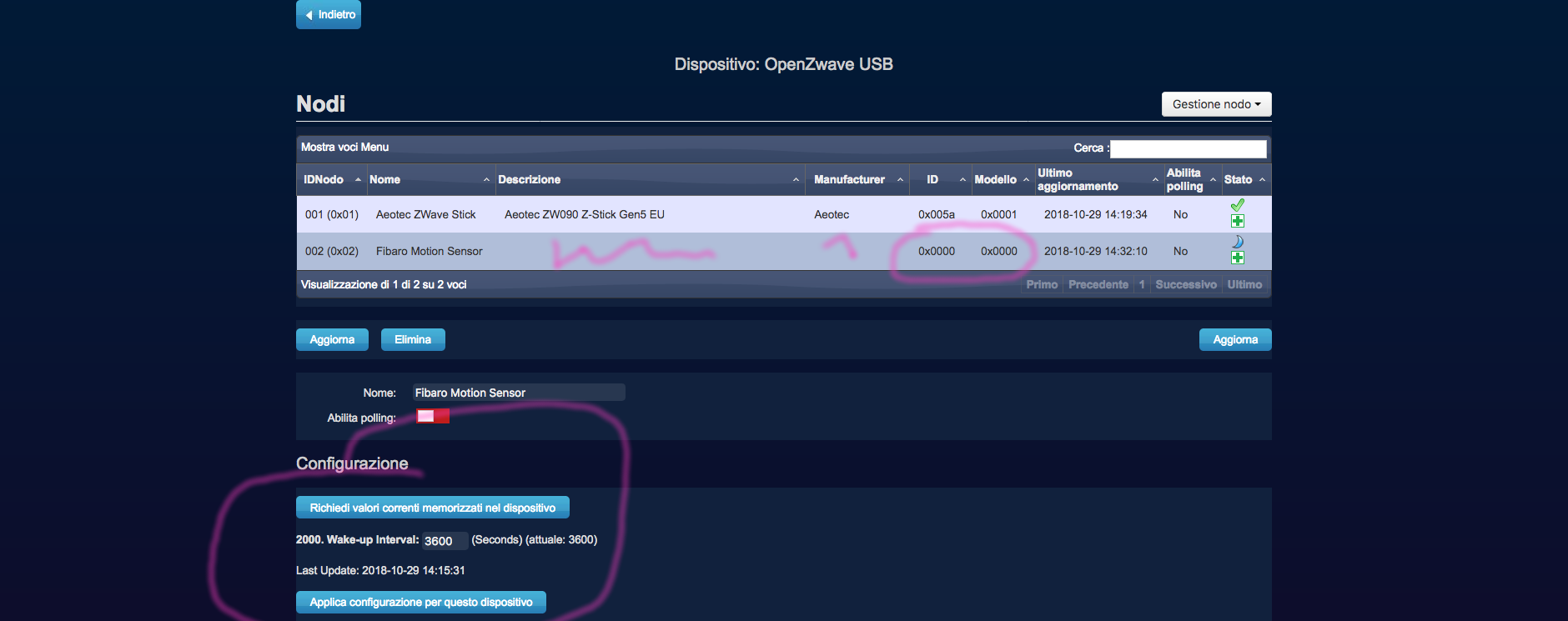

Hi guys, i've a problem with fibaro motion sensor, not give any infomation and conseguence is no configuration, look this screen:
What appended?
i already tried to reset zwave stick and fibaro motion sensor, no results

Solved!
You've to exclude node then include node and sensor born again!
