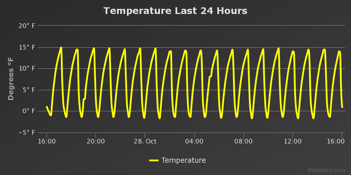

@DeBaat I thought of that ... the maximum temp reached at the defrost cycle is 46.6F so YES, I could certainly set the cycle to 47F.
The defrost cycle only lasts 23 minutes - then the temp goes back to -1.5F - not too long for the contents to defrost and spoil.
So I'm thinking my criteria SHOULD be time-sensitive.
If it is over the normal high of +15F [see daily chart below] for more than 25 minutes THEN i should be concerned.
That might just be the same as an action over 47F ... I'll just have to think about that.
I still want to be notified of HOW LONG it has been over 47F ... a few minutes would be OK.
An hour and the food is starting to thaw.
Over 47F for 5 hours and it's getting time to pitch the food.
But Hey - thanks for the constructive comment. It got me thinking.
So how could I add a timer variable ... how long is the temp over 47F ??
