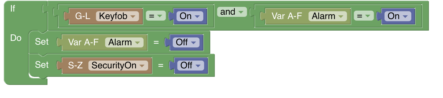

We have a Blockly script for a one button Neo keyfob (it sends only an “On” command.)
The script is: If Keyfob=On and Var Alarm=Off
Set Var Alarm=On
That script is working perfect and every time when we push the button at the key fob it toggles the Variable Alarm from On to Off and Vice versa. (And a Virtual Device is also listening working well with that Variable, it goes on and off with a Blockly script.)
BUT:

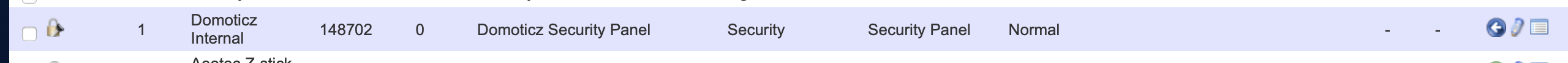

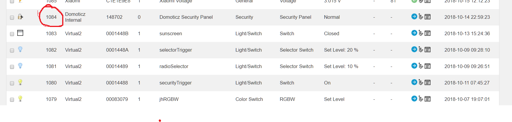

Than we made the Lua script below to change the Domoticz Security Panel.
Unfortunately then the Variable “Alarm” (of the Blockly script above) comes in a loop and several times in a row the Domticz security panel displays Armed and Disarmed (see log below).
How is it possible that the Lua script which has only to READ the Variable “Alarm” also changes the Variable? (we saw it automatically changing serval times in the Variable window)
(The only script that may change this Variable “Alarm” is the Blockly script above with the keyfob!
What’s going wrong here?
Thanks for there help and kind regards,
John

I only see it being DisarmedMcJohn wrote: Sunday 14 October 2018 21:47 We have a Blockly script for a one button Neo keyfob (it sends only an “On” command.)
Set Var Alarm=On
Unfortunately then the Variable “Alarm” (of the Blockly script above) comes in a loop and several times in a row the Domoticz security panel displays Armed and Disarmed (see log below).
Tried to reproduce with dzVents script.How is it possible that the Lua script which has only to READ the Variable “Alarm” also changes the Variable? (we saw it automatically changing serval times in the Variable window)
What’s going wrong here?Code: Select all

local securityPanel = dz.devices(1084)

Can you confirm that the Lua script is saved as to be triggered by UserVariable and not by "All" ?

Yes, you have to change the number 1084 to the number of your security device. Sorry if that was not clearMcJohn wrote: Monday 15 October 2018 8:41 - We tried your dzVents script but then nothing happened with the Domoticz security panel.

I doubt that the number you use for the security panel is correct. Did you got that number from the http://DOMOTICZ_IP:DOMOTICZ_PORT/#/Devices ?

The ID of the security panel is indeed 148702.
See enclosed screendump. And this is your script:
And below is the BlocklyOn of the Variable:

From what I see on your screenshot the id = 1McJohn wrote: Monday 15 October 2018 12:56 Thanks for the explanation.
McJohn
- Posts: 91
- Joined: Wednesday 10 October 2018 17:01
- Domoticz version: 2020.2
Re: LUA script (to the security panel) also changes automatically another Variable which is not in the script (only to r
Sorry sorry for the wrong number. Changed it to 1 but unfortunately no result
I think I "know" what the problem is:
Domoticz (or the Z-Stick) automatically switches off the keyfob after 1 minute.
And your script response on that (and won't also fire anymore when the keyfob is in "on" status to Trigger disarmed.
Could you change your script that it only fires (Armed and Disarmed) with the Keyfob On command
(like my simple BLockly to Variable does)
Thanks for all your effort!
