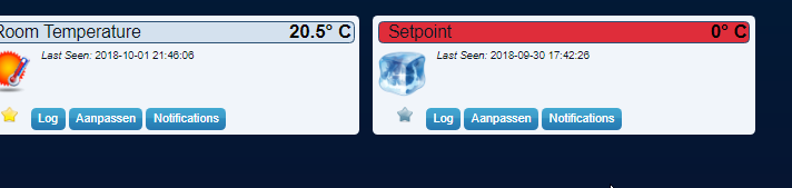

I'm new to Domoticz, and also LUA. What i'm trying is overlaying multiple temperature (sensors) data in a single graph, including the setpoint temp of my Toon thermostat.
I tried building a (what should be) really easy script including the dummy sensor described in multiple topics. I tried to follow the Weatherunderground temperature scraping example, and modified it slightly in which I thought it should work.... however it doens't.
Can somebody please advice me/looking at this script? As can be seen in the attachment it is printing the input ( Room Setpoint --> sWeathertemp ), however it does not update the dummy temp sensor Setpoint ( idx 18 ).
Looking at the script it's also repeating once triggered, how can I stop it after 1 cycle?
( For me it would be easier if this would have been possible in blockly )

Re: LUA Setpoint temperature to Temperature conversion
Bart1992 wrote: Monday 01 October 2018 22:09 ...What i'm trying is overlaying multiple temperature (sensors) data in a single graph, including the setpoint temp of my Toon thermostat.
The code is probably saved as a "Device" or "All" triggered Lua script. In that case it is triggered on every device change in the system and every minute.
In this case it makes more sense to save it as a Time triggered script.
The previous Lua script was based on my testing on an Evo home temperature + setPoint device.
For a Toon setpoint the script is even more simple

Bart1992
Joined: Monday 01 October 2018 21:56
Post by Bart1992 »
Thanks! Your last small script did the trick, seems really easy when you know the syntax :) !
