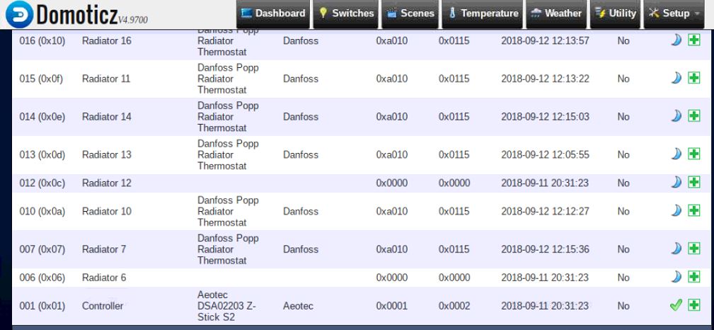

I am a noob and this is my first Zwave network.
I have a Raspberry Pi3 running Domoticz v4.9700 and using an Aeon S2 Zstick controller. I updated to latest version of Domoticz few weeks ago. I have just been through the process of "include"ing my Popp TRV radiator valves of which I have 12 and the Popp TRV valves all indicated a successful "include" at the time. They are brand new devices which were not used in other networks previously.
9 of them I can connect to on domoticz, they appear on the node list and automatically get added to the device list. 3 of them (which are the ones physically furthest away) I cannot connect to despite putting them in active mode several times and clicking sending "Request current stored values from devices" many times. I have even tried "Heal Network", not sure what that does but it had no effect.
I suspect that the devices are only talking to the controller and not talking to each other and the furthest ones cannot make contact. I have attached here my Nodes List showing the items "0x000" which have not connected and the "Groups and Networks" which does not show any interconnections. How do I get the devices to talk to each other or am I doing something else wrong ?? Thanks for any help

For some reason my post lost the critical screenshot. Here it is :oops:

I think I've found my issue.
TRVs don't have association groups because they can't control something else.
viewtopic.php?t=5981
This is why all of them are only trying to talk to the controller and 3 can't reach it :( .
https://domoticz.com/forum/viewtopic.ph ... de#p187438
I need to get a relay (or move my controller somewhere more house central-ish)
